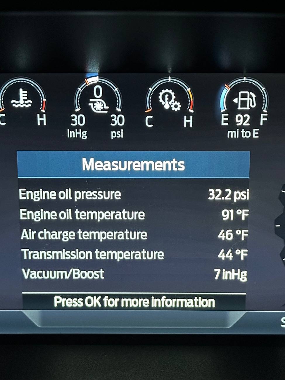

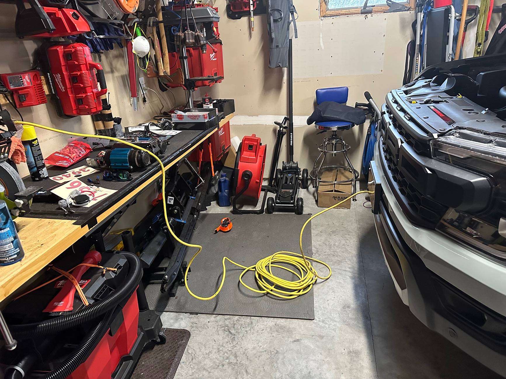

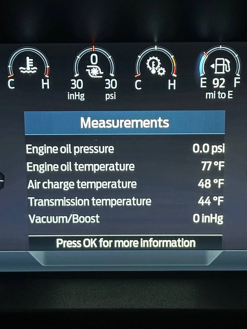

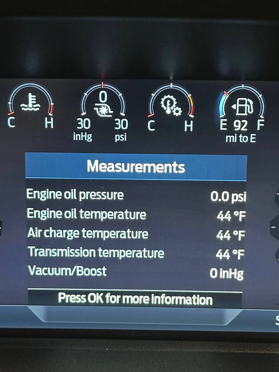

So I was curious how well the block heater performed. I figured if cold starts are tough on the cam phasers maybe this would be an option to try.
Plugged in to a 15A outlet. Think it drew 300-400 watts as I have solar and can see demand and supply on a graph.
Started at 44 in my garage.
After 1 hour it was 77f
After 2 hours it was 91f
Effectively a summer “cold start.”
Thought it was pretty neat.

This seems weird to me that the coolant temp gauge did not move, but the oil temp went up. The heater is in the water jacket of the block not the oil pan. Those seem like weird results.

I’m not really surprised by water temp. There’s no water flow and convection isn’t really going to move the water past a closed thermostat. So my guess is that the heating of the water and the temp sensor are far enough apart…

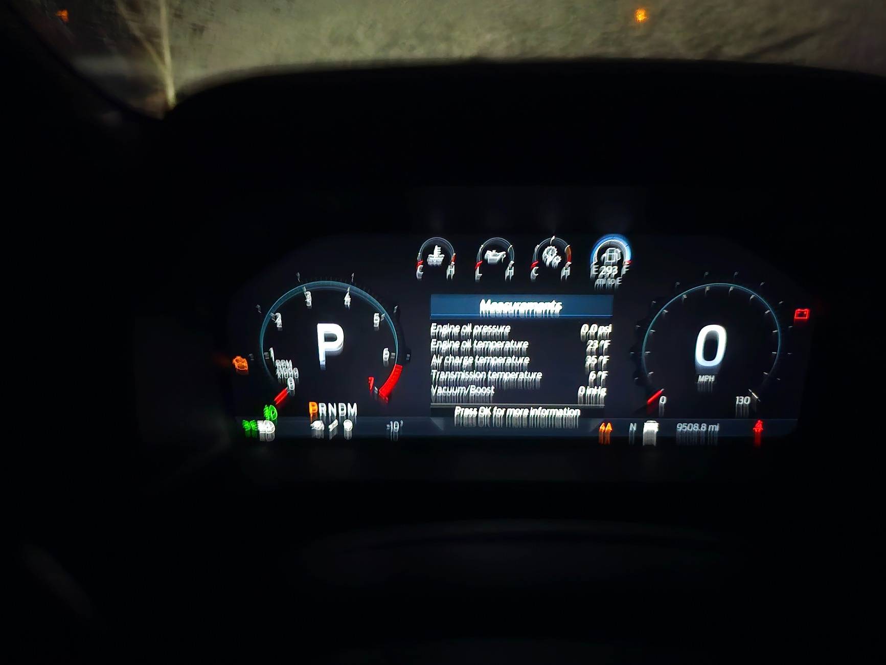

I was curious about my engine block heater, so I plugged mine in about four hours ago, these were my readings after being plugged in. It's -10° F outside temp, with a good amount of wind and the truck is not garaged. Sorry the one photo is blurry the camera went into night mode. Anyways, it's the cylinder heads 140°F, engine oil temp was 23°F. Everything else looked unimpacted.
