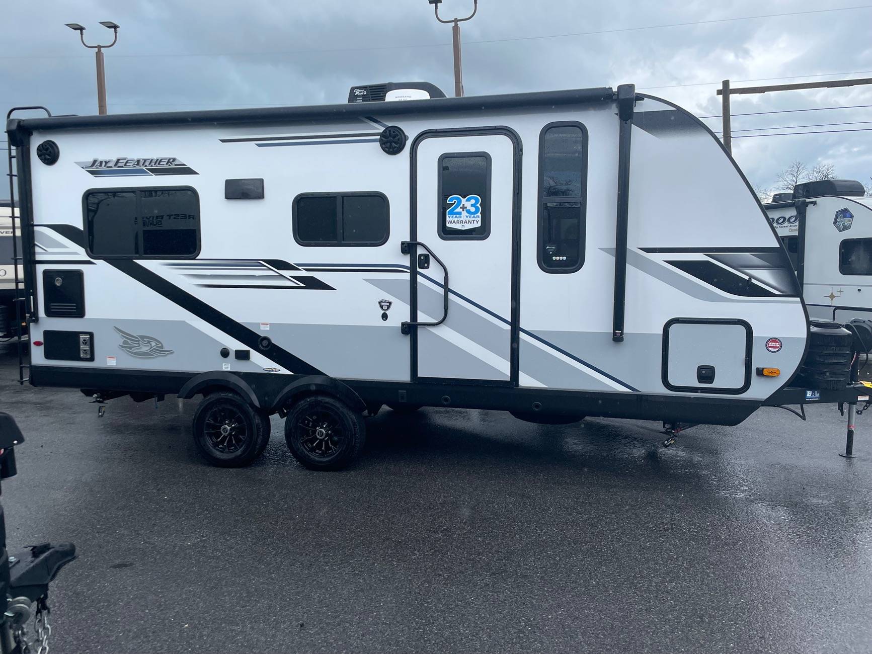

2025 Ranger 2.7
2025 Ranger 2.7 Advanced Tow Package
Jayco 19MRK UVW: 4960 GVWR: 6400 Hitch:565 Exterior Length: 23’ 2”
Equalizer E2 WDH - Weight: 116
Please let me know your thoughts, advice, personal experiences etc etc. (Perfectly fine, pushing the limits, Just because you can doesn’t mean you should)

Nice looking camper, I'm looking at similar ones. Let me know how it goes.

Looks like Keystone RV just over the PA border. Are you planning to use stabilizer bars for towing? I have looked at some R-POD models as well because of the size and weight, the need additional space is nice though based upon your picture. Heading out to camp you would be close to the limits of the truck than coming back home with less food, water and other supplies. Personally, I wouldn’t want to climb mountains with the truck maxed out, but that’s just me. Hope that helps.

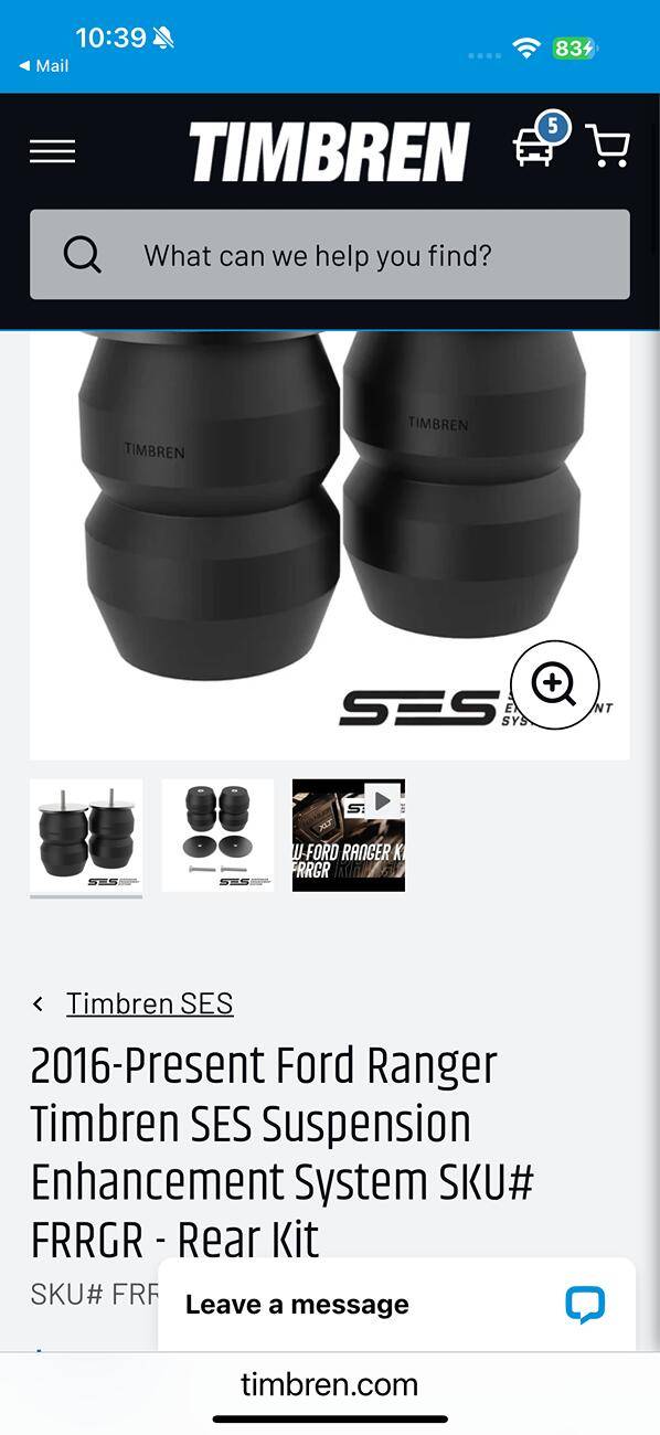

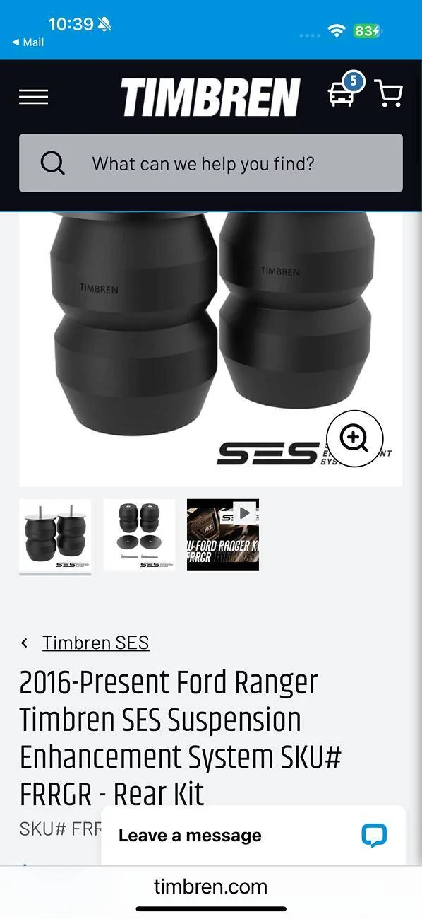

Cheap and effective. Ived used them on F1 Raptors and F250’s.
Rides level, no body roll, and steering feels factory instead of light with the headlights up in the air. Video in the listing also.
Timbren Active Bump Stops
