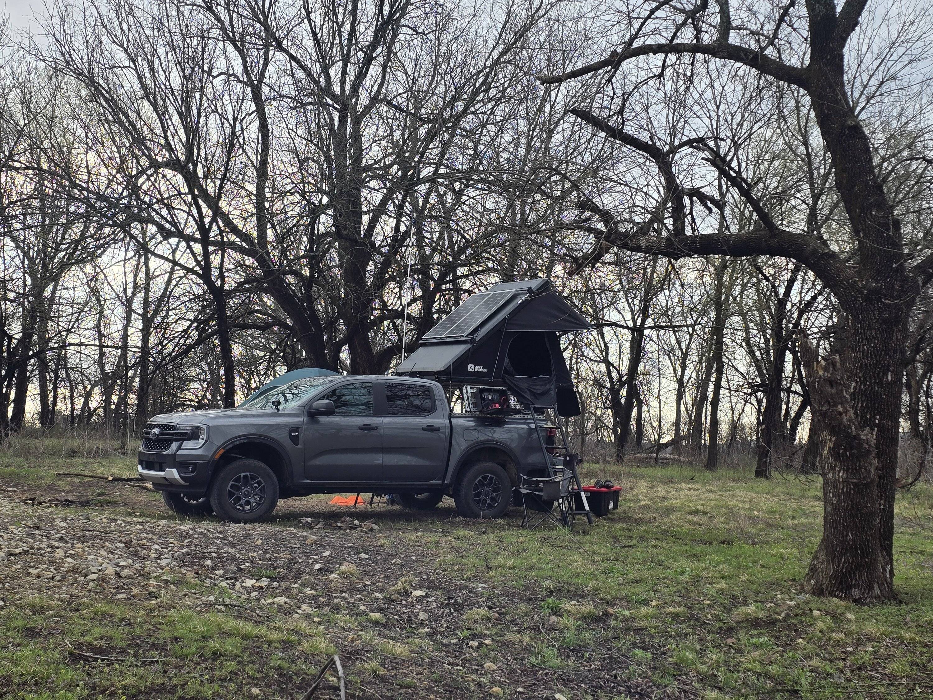

Greatings y'all, quick question regarding lift blocks. I added a front leveling kit a few weeks ago. Looks great, love the stance, except when I add my overland rack and hard shell RTT, or tow my utility trailer. Maybe it's me, but looks like it adds a bit of negative rake. I'm considering a simple one inch Lift block in the rear. Anybody added a set and have you noticed any adverse effects, such as drive line vibration or needed a longer driveshaft? I've done blocks on older trucks in the past with no issues, but I wanted to double check on our vehicles before pulling the trigger. Thanks.
