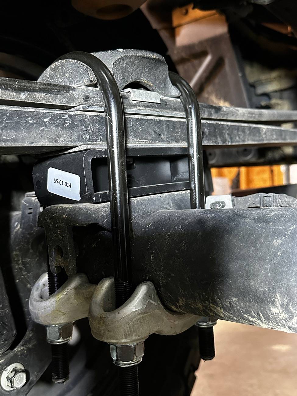

So for background I had the Superlift 2.5" front leveling kit installed with 1.5" Rough Country rear blocks. The install was unintentionally done in phases. First week they did the front lift and the new tires (Cooper AT3 XLT 275R70/18). Drove it home and a couple hundred miles, no issues. Next week they install the rear blocks and now I consistently feel a vibration from take off at low speeds. Like 0-30ish. No felt issues above 30mph. I checked the rear blocks. They appear installed correctly. I checked the U bolt torque, they're in spec. Tires are inflated correctly. I don't imagine that installing the rear blocks would affect the balance of the rear tires, even if they removed them to do the install.
Kinda stumped. I'm super happy with the way the truck looks now but something seems off. Any ideas or suggestions on what the issue might be?

No assumption. If there were shims I'd see them. No shims here
Bottomline, these are suggests as to what the possible issue is. No one here has any idea what your installer has done or needs to do. It’s your truck and you need to do what you think is right.
I’d talk to the installer first before attempting to correct a possible issue. They’re the only ones familiar with your install.🇺🇸
