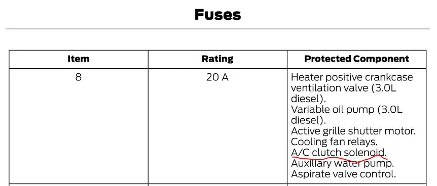

I did notice the AC clutch didn't engage when I turned on the AC this morning. I went to look at the fuses but the panel is blank, no fuse labeling. The owners guide in the infotainment screen wasn't much help. Quick online search wasn't much help either. Engine bay was too hot to reach down and check connections. Only other thing I can think of is leaked refrigerant, assuming it was ever filled at all.

Try Engine Compartment Fuse #8. A/C clutch solenoid. Info starts on page 386 of the owner's manual, along with a fuse box diagram. Not sure if there is a relay associated with this and have not seen which relay it would be.
Also can go here, which has more info than printed manual. Just search for relay or fuse.
2024 Ranger Owner's Manual (fordservicecontent.com)

Thanks, the diagram is helpful. The one on the screen in the truck can't be zoomed in so kind of pointless. I'll check the fuses but seeing as they share the same circuit as the grill shutter motor, I know those work. Could be a relay like you said. Will have to look some more. Maybe I'll just start tapping on all the relays.

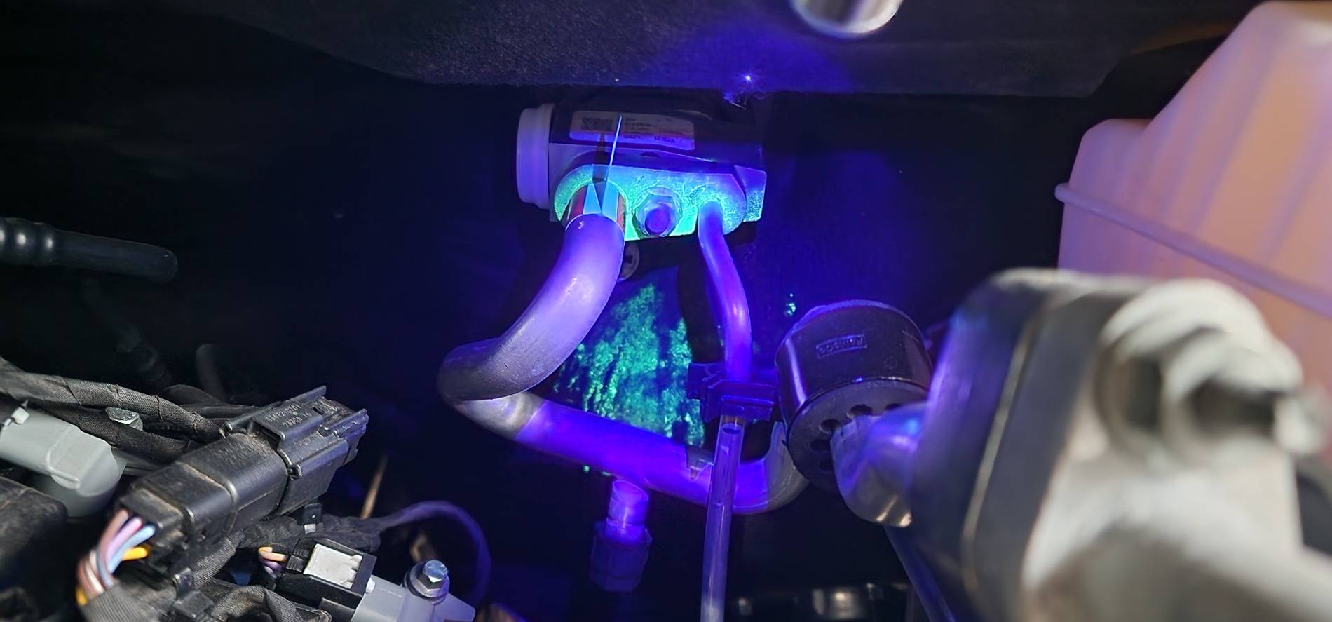

Got back in town tonight. 1,980 miles of fun in the truck, albeit without A/C. Decided to take a look at the A/C a little closer and broke out the UV light and found what appears to be A/C dye signifying a leak. What do you think?
Ford Ranger No A/C 20240413_222430
Scheduled an appointment for service at the closest dealership on Monday. We'll see what they say.

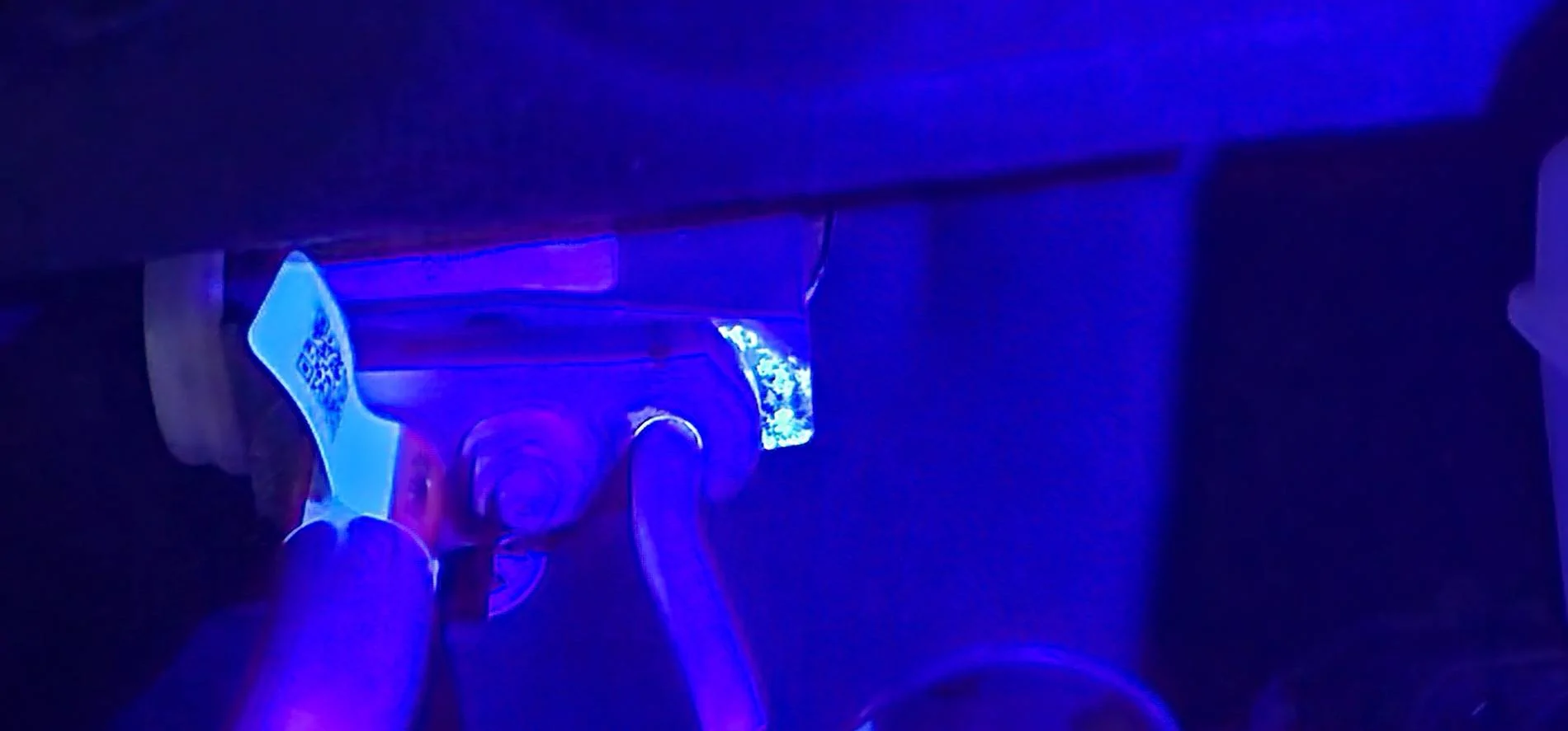

Update:
Headed out to trivia after work today and had passengers so I turned on the AC only to have...warm air. Seriously?
Got out the trusty UV light again to check...
Ford Ranger No A/C 20240604_193301
That's worse than the first time. Really?
Welp. Making a very agitated phone call in the morning.

When you get it back from them this time, shine your UV light at the repair and make sure they actually cleaned the dye off. I chased a leak for a couple months more than I needed to because of that

Yes! I was discussing this yesterday with a buddy of mine. So thanks for the reminder because I did forget already. Taking it in tomorrow morning. Rode the bike today because, hey, nice weather and no AC.
