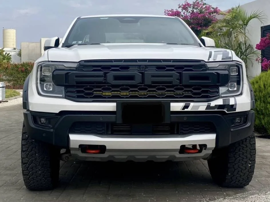

Yes you have to cut the grill but this is what I'm leaning towards...

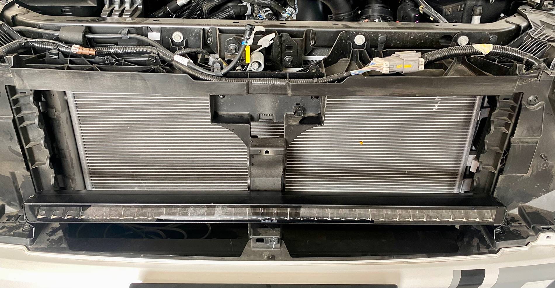

Don’t forget the overseas Raptors don’t come with Grille Shudders and from those videos they appear to have a lot more room cause of it.
The US Built ones have shudders behind the grill which take up room.
Fitment will be a bit tighter.

Yeah we are in guinea pig territory still with the US model. The UK version is similar to the US in that it has the active shutters. STEDI did mention out of all their UK customers only one had issues with the louvers/slats from the shutter system. Whether that be from bracket positioning or just the installer tightening everything down before confirming that tight fit who knows. I'm willing to modify the bracket or remove a select few louvers where the lights would sit. But not willing to remove the shutter system altogether as that will throw some codes and slow down engine heat up in the winter.

I have a 32" Hella Black Magic from Amazon. No trimming needed. The slim all black design keeps it low-key behind the grille.
