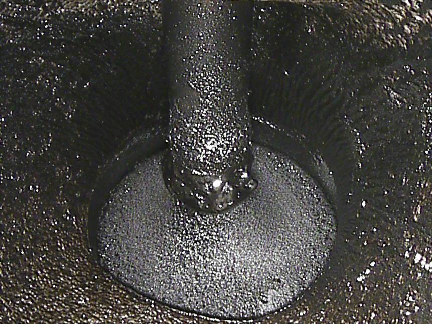

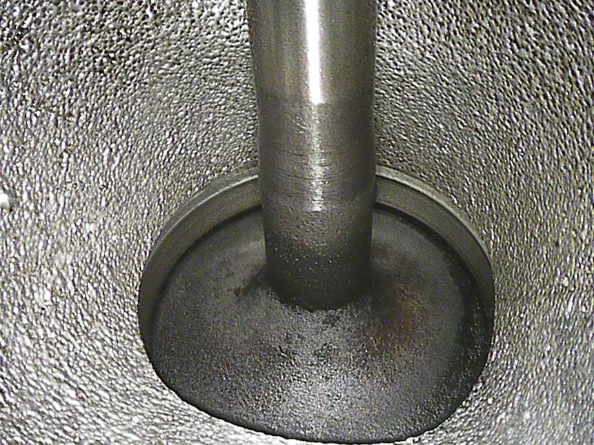

I’m going to disagree with you here with evidence. The Fuel/Air induction service is completely effective thru the entire fuel system from the back of the TB - Intake valves.
Allowing carbon deposits to accumulate on intake valve stems, GDI’s, FI‘s
  • Reduces fuel efficiency
  • Reduces vehicle performance and power
  • Provides costly component repairs
and only becomes progressive worse with time. Removing the buildup at set intervals of 15K or once every year, solves the problem of buildup.
Walnut/apricot blasting, is a repair and avoidable. With the understanding, removal of the intake manifold/s, turbocharger/s, and in some cases the entire head/s to gain proper access to the intake valves, along with removal of GDI‘s, FI’s and TB is costly repair, not maintenance. All this can result in a repair bill of several thousands of dollars.
Below is photographic evidence of a complete GDI Fuel/Air Induction System service;
Before;

After;

This Field/Air induction service was conducted at 15K on a 2.3 Ford eco boost GDI engine. It directly removes carbon deposits from Intakes valves and all accumulated carbon deposits on associated fuel system parts.
I’ve utilized Fuel/Air induction services exclusively for all GDI engine over the past 15 or so years, on several different makes/models. All have produce the same results as pictured above. Yes, its not cheap but is part of GDI engine maintenance cost.
