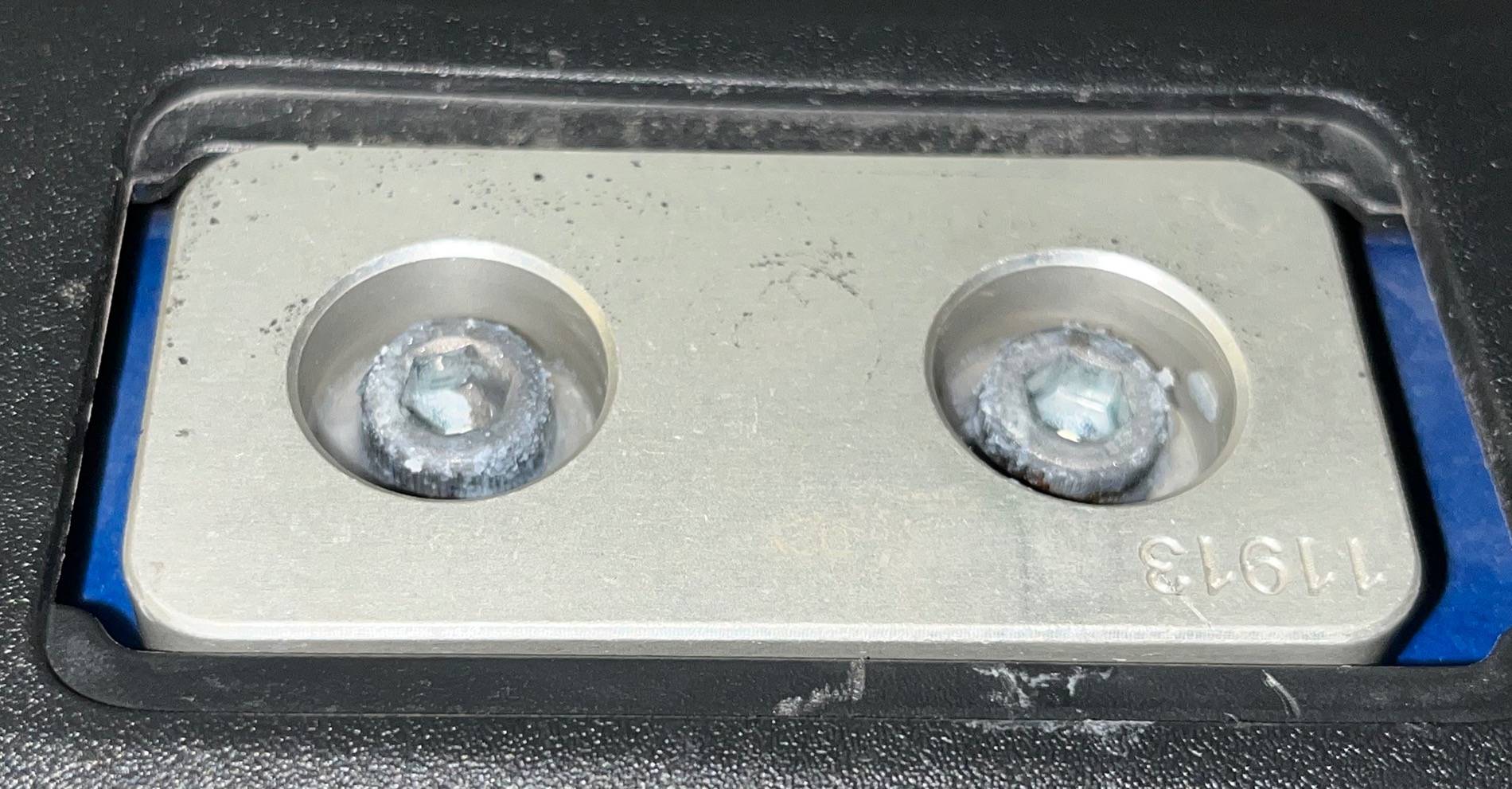

This applies to aluminum spacers which are not properly sealed. My RR has a Go Fast Campers Topper and their spacers have a problem for sure. This is after just 8 weeks and some mountain passes with deicer on the road surface.
Ford Ranger Heads up - stake pocket shims/ spacers corroding. IMG_8734
Please read this thread for more information and a solution.
https://forum.gofastcampers.com/t/2024-ranger-stake-pocket-shims-spacers-corroding/32818
Please post any similar issues that you might have encountered. Thanks,

That’s what road salt does to uncoated aluminum.
They are clear anodized and the aluminum parts didn’t show any signs of corrosion. It was the bolts. The white stuff at the bottom of the cavities was salt, which cleaned up fine. I completely encased them with silicone sealer to eliminate any future “fluid” entry.

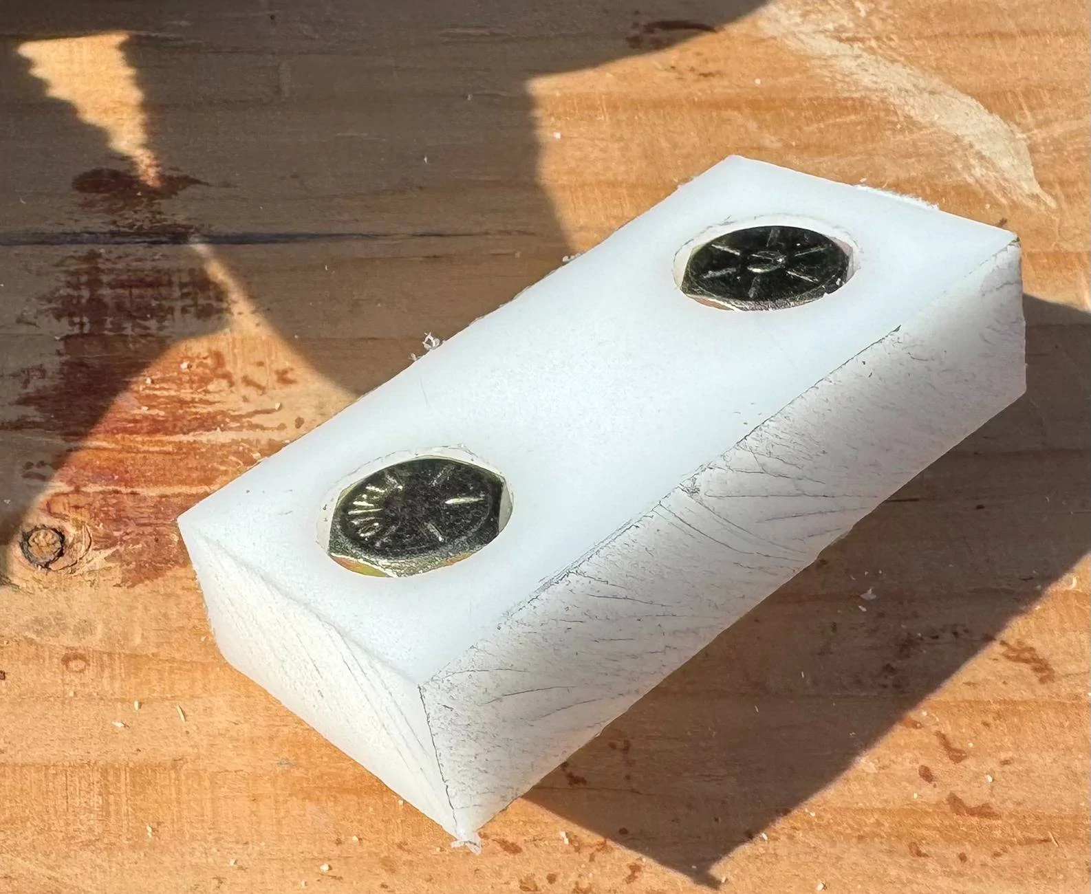

I read your post on the GFC campers forum. Great job on the silicone on the trim pieces! I am going to seal mine too before I install my tonneau cover. I hadn't considered masking, now I will.
I am likely going to make my own stake pocket shims from Delrin and seal the pockets too. Delrin certainly won't be a strong as your aluminum shims, but should be fine for a tonneau. Most people don't even use shims for just a tonneau, but I want it to be strong.
I talked to GFC about a set of shims last week, they are considering. I know they have said "no" in the past, but we'll see. Buckle Up Off-Road makes a set, but they won't be available for another 4 to 6 weeks apparently.

You also need to go to stainless hardware. Looks like galvanized allen bolts were used in place of stainless steel hardware.🇺🇸

D. Sampson: Delrin or acetyl will be fine for your use, I would prefer it over aluminum since it is crazy strong and almost completely inert. And no worries about dissimilar metal corrosion. If you are machining them, use an anti-static spray or you will have a huge amount of stuck particles on your work piece and mill.

Galvanic corrosion is why I'm hesitant to put aluminum skid plates on my RR. I don't know if that's what your experiencing, but you might want to research it.

I made these shims out of Delrin hard plastic. Just for some extra support under my tonneau. Not super pretty, but worked for me.

What are the Dimensions of these??
thanks
I used 3/4" thick Delrin plastic. The shims for the front four pockets were 2 7/8" x 1 1/4". The shims for the back two pockets were slightly less thick, maybe 1/8" less. I didn't write down the dimensions of the last two, I apologize. The last two thinner ones were a pain in the butt for me, I hade to hack away some of the Delrin.
I have a unused set of the "Go Fast Camper" shims as well. When I get a chance, I'll take some measurements of those and post back.
