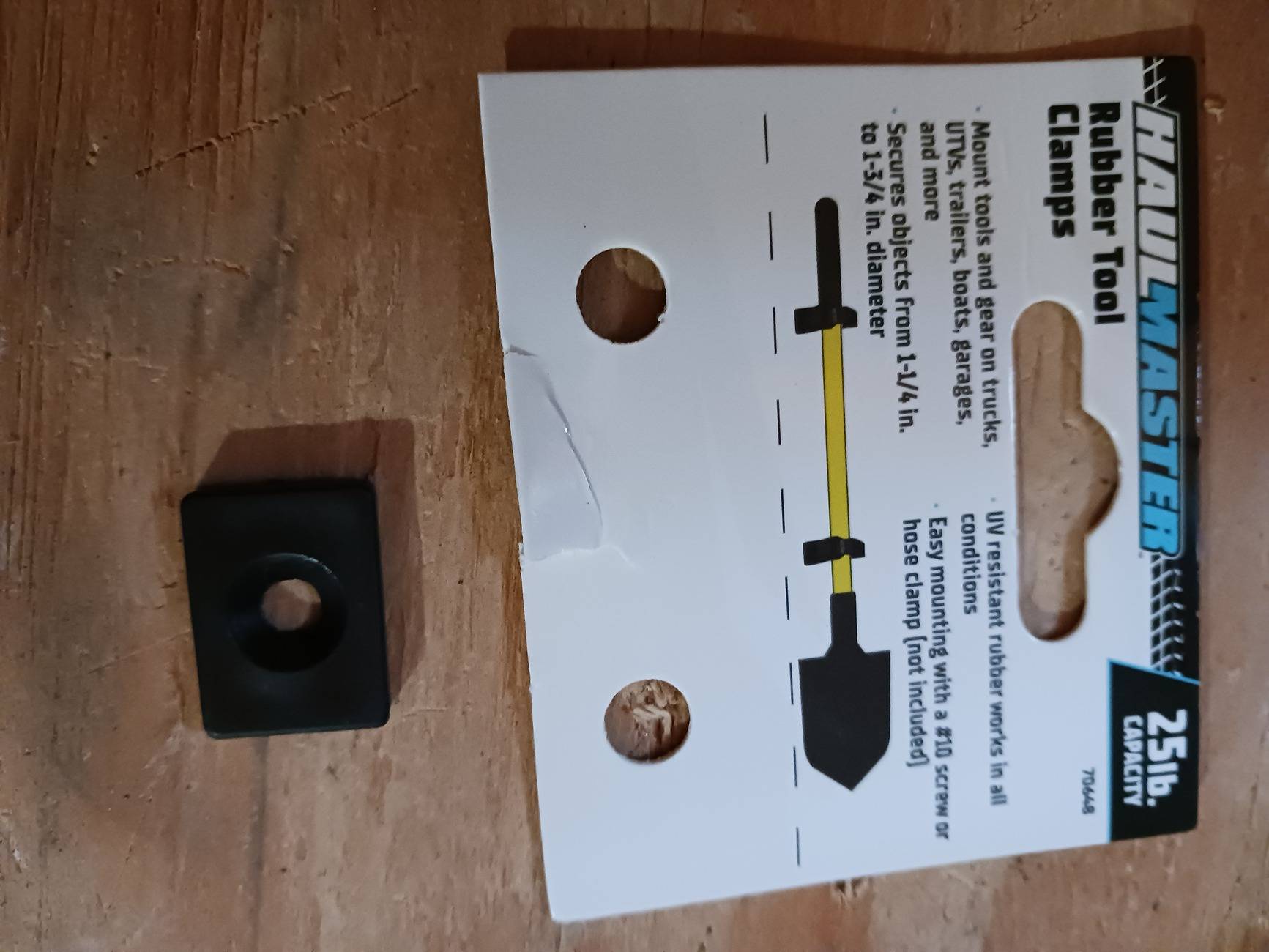

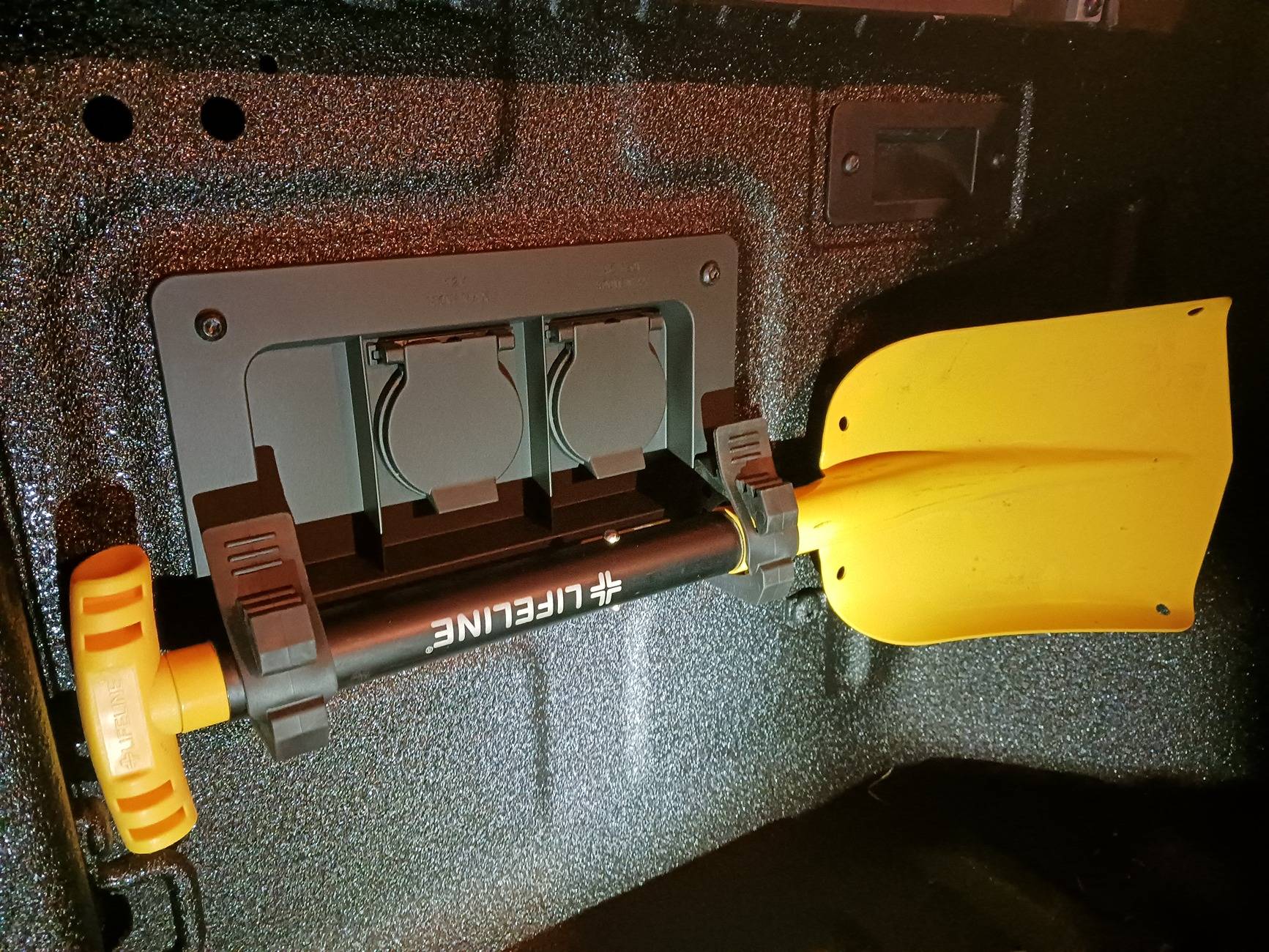

Bottom T30 screws for outlet molding work great for attaching the rubber mounts. Just take out the hard plastic piece (pictured with label) and replace
Ford Ranger Harbor Freight shovel mounts 20241229_153007
Ford Ranger Harbor Freight shovel mounts 20241229_153052
replace with a washer. 3 bucks each.

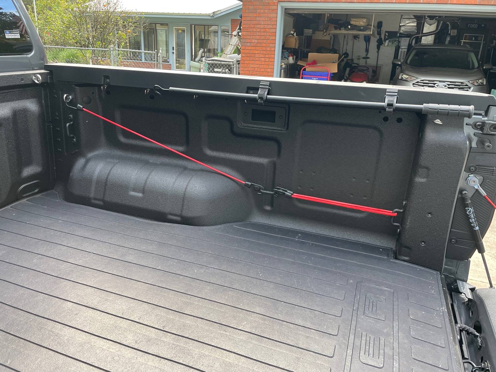

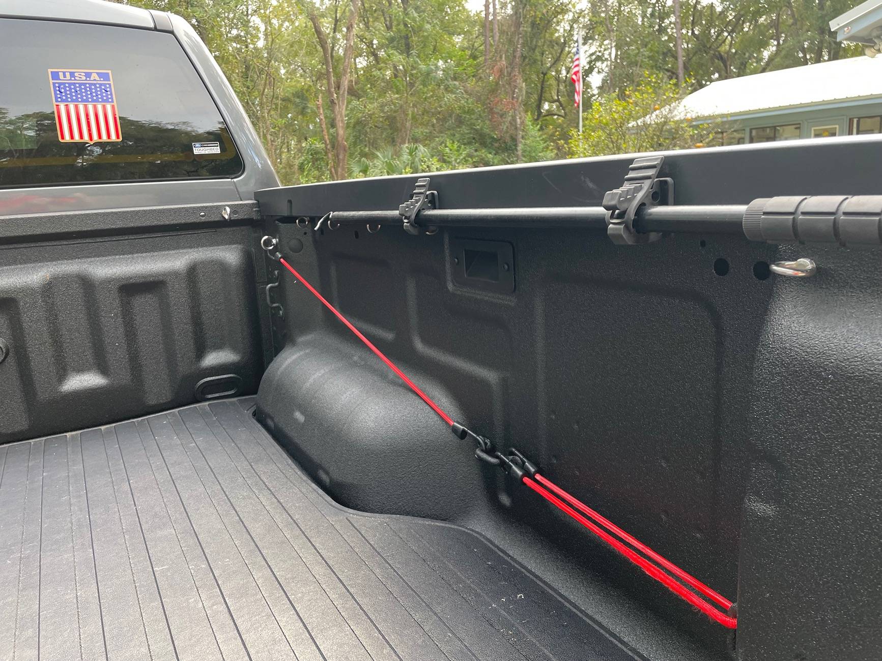

Yeah I bought the quick fist one from Amazon. More experience but I hadn’t seen the HF version.

Thanks for sharing this! Good tip!
