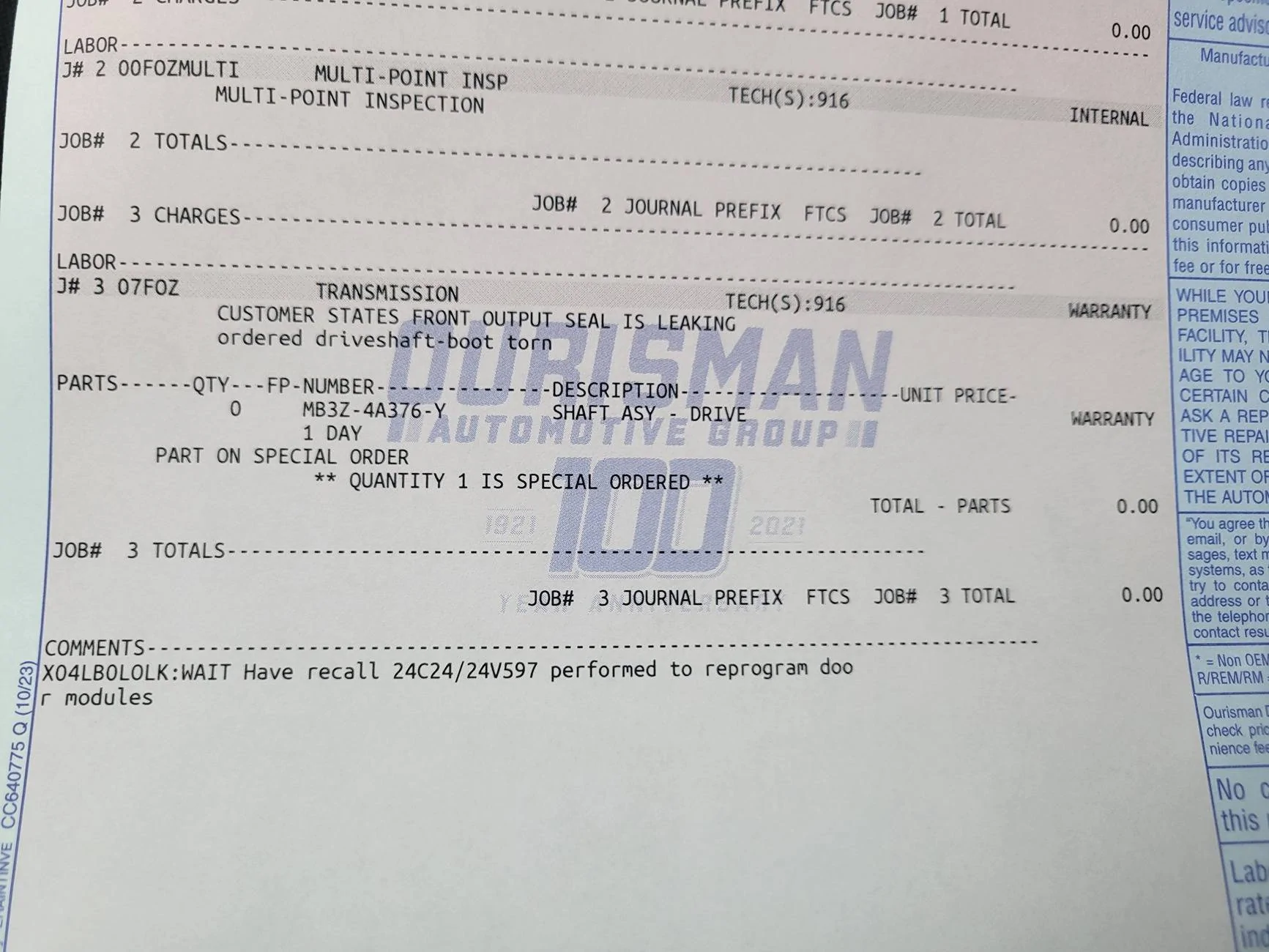

Got under the Ranger this morning prepping for a oil change and noticed my front driveshaft rzeppa joint leaking grease out from under the boot and slinging it. I was able to get the boot to rotate on the radial and it seems the band clamp is not tight enough. I seem to recall another member here posting something similar but cannot find that post off hand.

They are replacing the whole driveshaft and put it on order. There was no pushback of any kind from them.

They made the call themselves. This was a add on when I dropped it off this morning for my original appointment for the door module reprogramming recall. Showed the service advisor the photo on my phone and was given the service ticket and told the replacement driveshaft is on order when I left.
No muss, no fuss.

Replacement front driveshaft was installed today. They got it last week but never bothered to call until I called them yesterday asking for status. No clue on how long it took them as I also bundled a wheel swap out while I was in and that took forever. I will get under it to inspect this weekend sometime and see if they bothered to clean up the slung grease.
