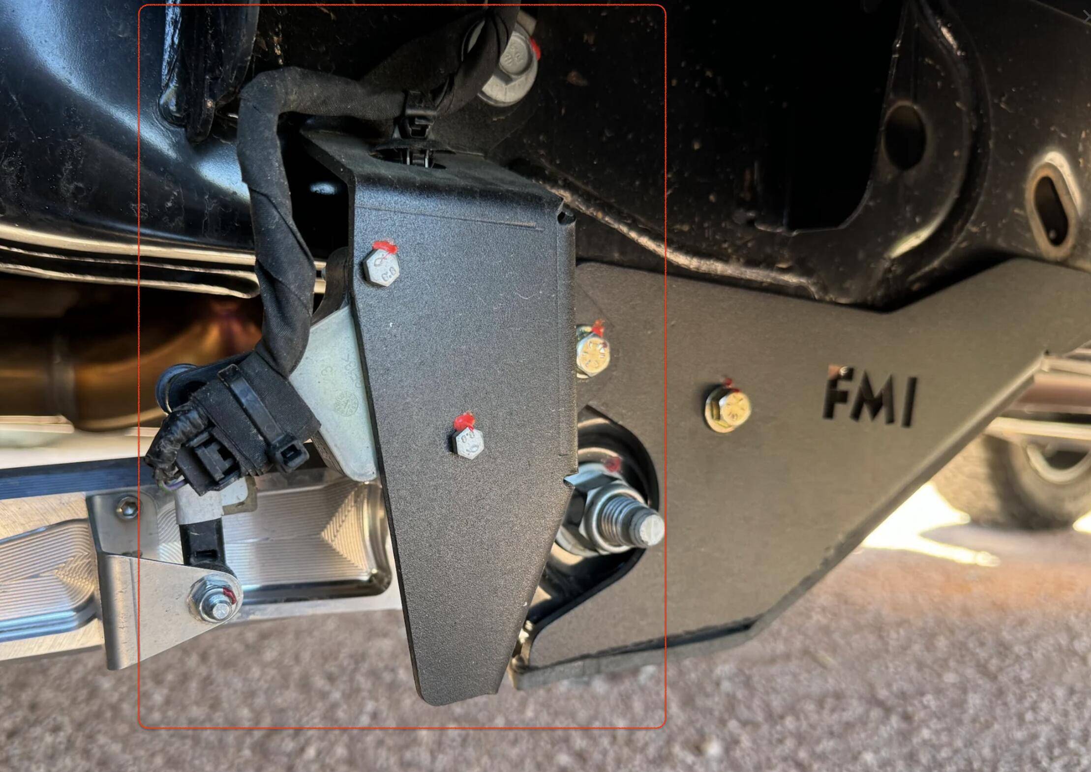

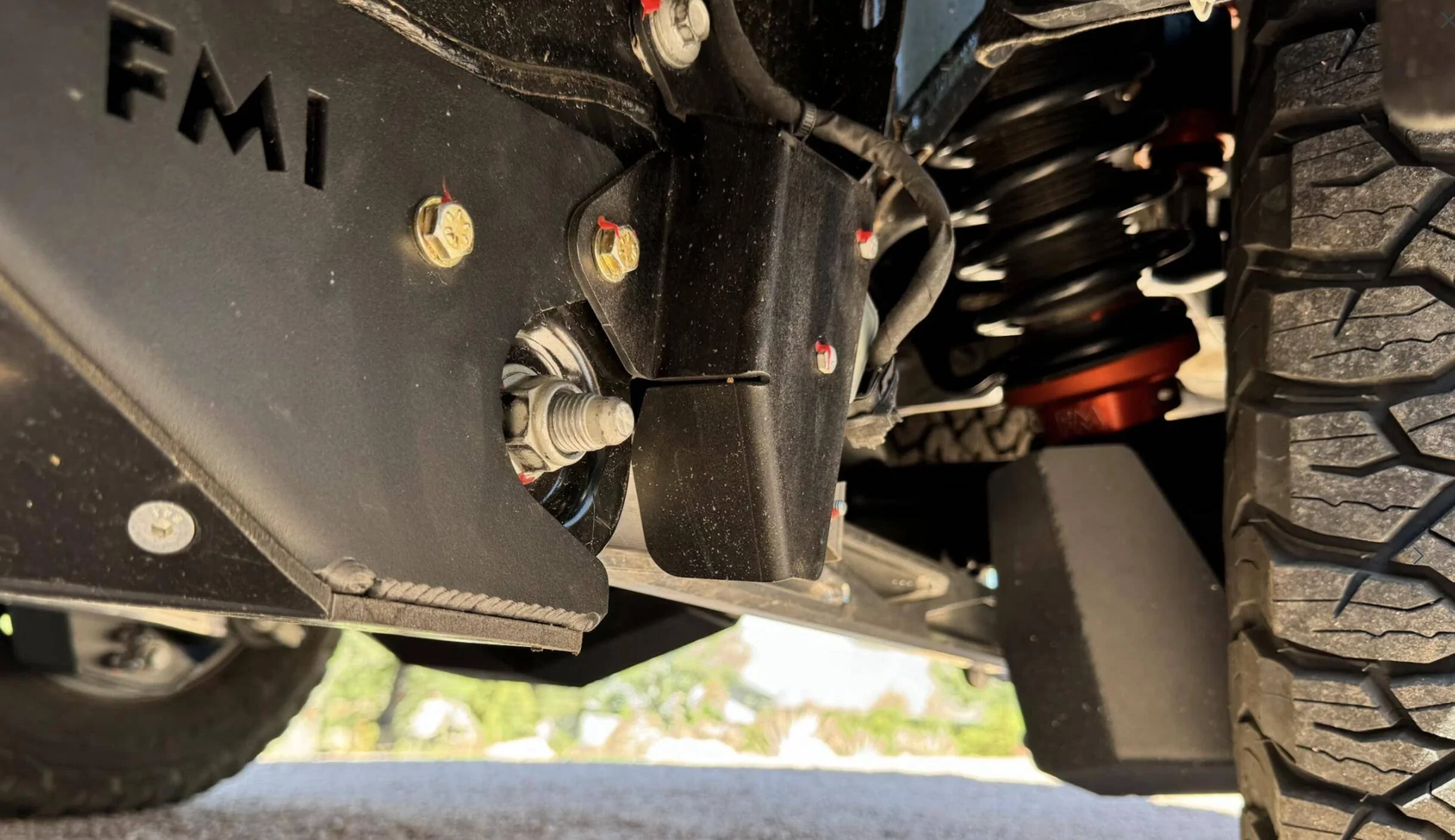

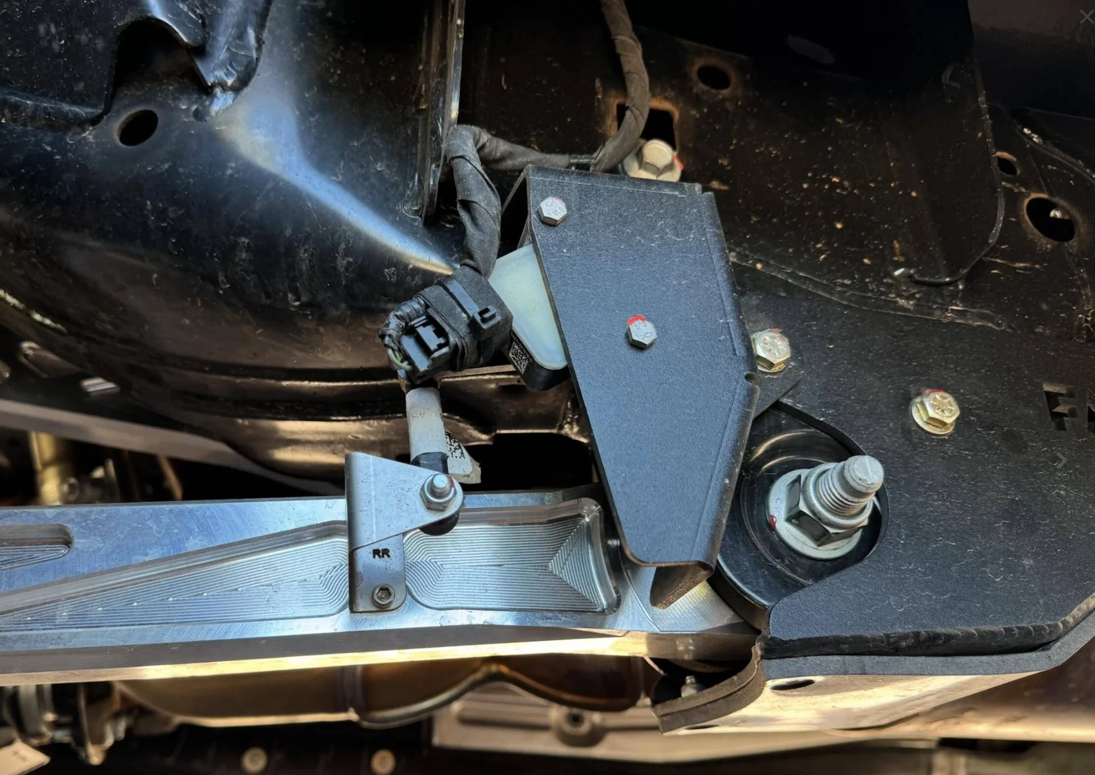

After removing my side steps I noticed the sensors seemed very vulnerable so I purchased them. Easy to install and looks like it will do the job. Hope this helps

Pics are pretty much the same as you see on this thread.
Remove the plastic cover and sensor bracket. The new cover attaches to the sensor where the old bracket did (Smaller bolts in the pics) then uses one of the bolts you removed from the plastic shield and a bolt provided with the kit to attach to the frame. About 30 minutes to install

@Franco appreciate the feedback...of those found on-line seems to be the most 'robust'.
Sounds like to issues with fitment based on your comments.
By chance, did you opt for the 'Add-on Sensor Wire Protector Plates' ?

Hey Joe - I am really new too this vehicle so when I removed the steps the issue became obvious. FMI seems to be focused on making the RR better so I looked to them first.
You are correct it is super robust
Two - Thanks for making me aware of the wire protector! Definitely gonna add!
