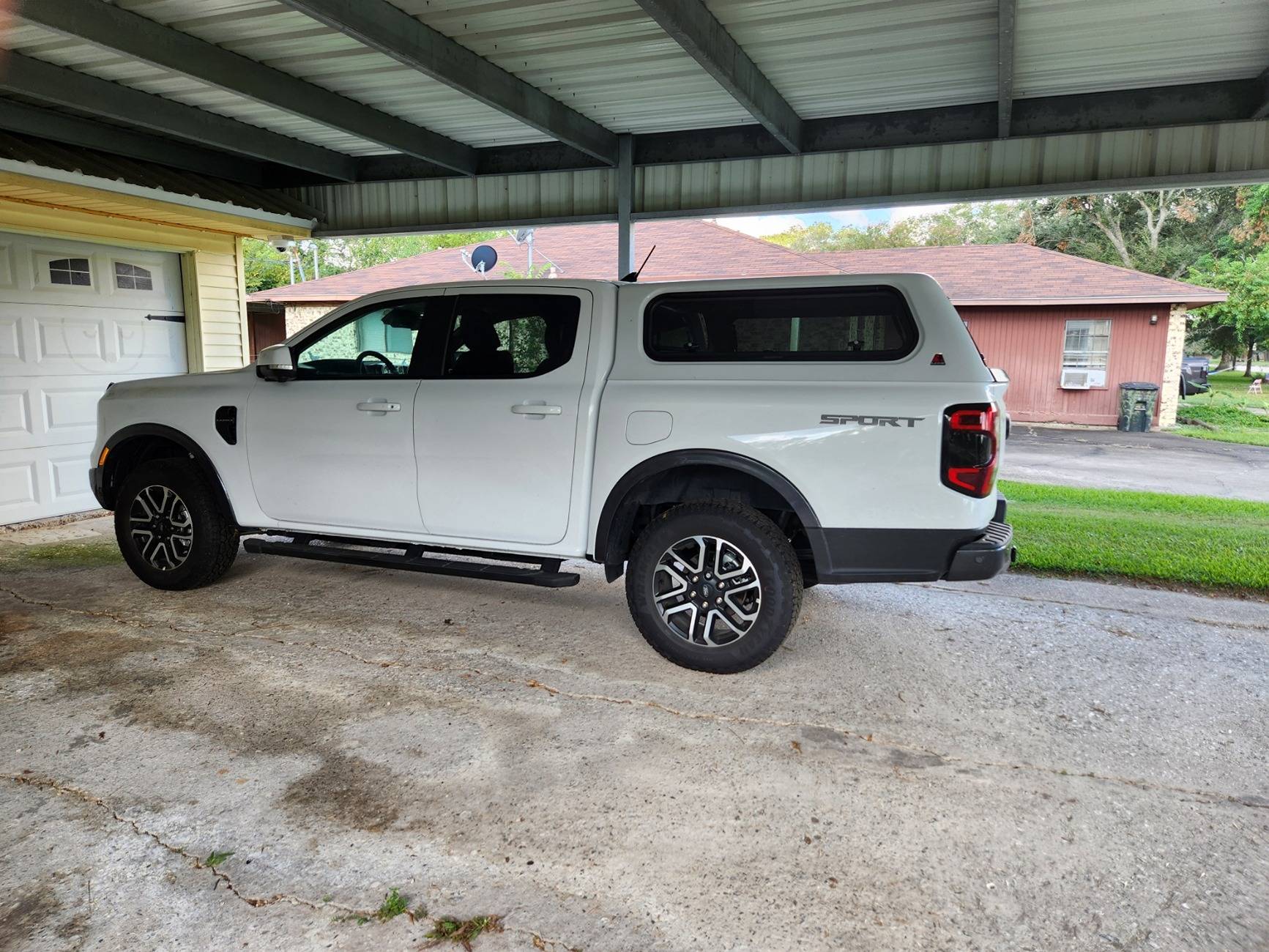

starsman53
Phil
Jun 7, 2024
Baytown Texas
2024 Ford Ranger Lariat
I have a Leer camper shell on my 2024 Ford Ranger Lariat and it seems to have not affected the level of the truck. I know the Raptor suspension is different but I wouldn't think the weight of the camper shell would affect the level of your truck.

djjohnr
Sep 22, 2024
California
Thanks! How well sealed have you found the bed to be? Any issues with dust ingress?
starsman53
Phil
Jun 7, 2024
Baytown Texas
I put in an ESI "ultimate tailgate seal" shortly before I had the camper shell installed. Since then, I've made one trip to West Texas for about 10 days. I spent a fair amount of time on dusty gravel roads; I didn't notice any dust infiltration.
