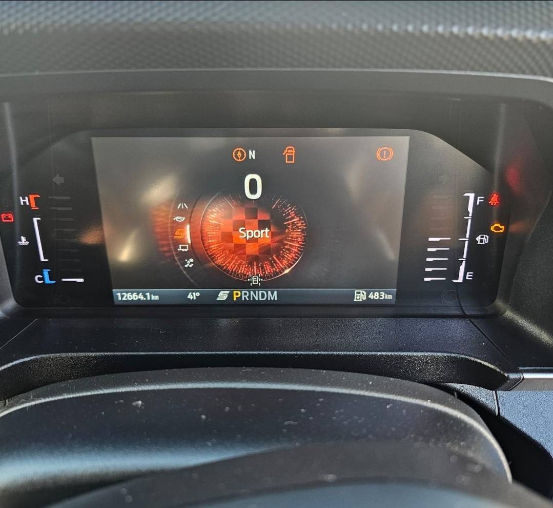

Hi LuckyPad, I already did these steps with no results, I would like to see someone who had results with the small cluster screen on XL or XLT

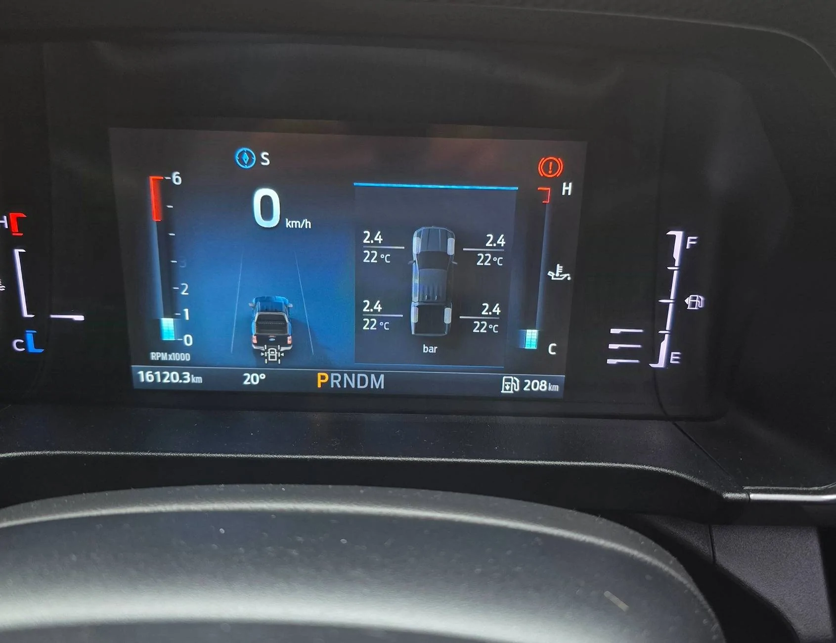

Mine came standard with the Normal, ECO, Slippery and Towing. Just added the Sport.
XLT.
Added TPMS over the weekend as well.
Do you have the mode selection button?
Ford Ranger Driving Modes Activation FordSport

No button here! … and the dealer advertised it as an XLT !! But reading the forum, I concluded that it’s the most basic AT version! Any Ford Motors representative here?
