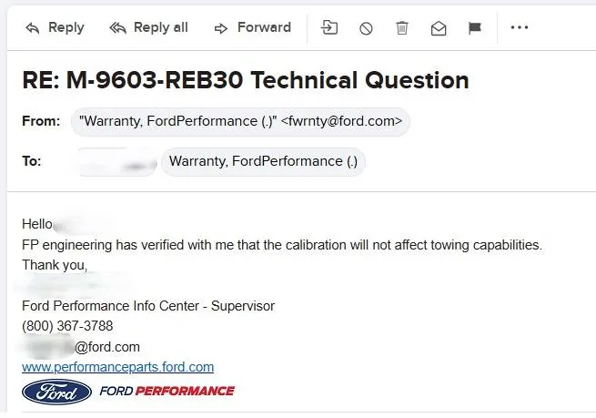

Hey all, I've seen some threads here before where people would say you should NOT tow anything with the ProCal tune installed. They didn't really provide any backing information on the topic, so I chatted with a rep from Ford Performance about it and they said it has no impact on towing whatsoever.
To be clear, I didn't buy my RR for towing. My wife wants to use it ~once a month to tow her horse (total trailer weight ~4,000 lbs) to trails and whatnot. I'm just hoping someone can provide a little more insight into if the tune affects towing ability and if it does, where is some technical information to back that up? Thanks!

Ford Ranger Does the Ford ProCal performance tune affect towing M-9603-REB30_Towing_Capability

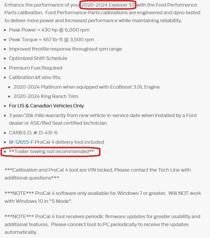

Getting back to the original question, in addition to the above posted information I provided directly from Ford Performance, if you look on their website for the Explorer ST Pro Cal as an alternate example, it explicitly states the following:
EXPLORER ST 3.0L ECOBOOST PERFORMANCE CALIBRATION| Part Details for M-9603-EX30 | Ford Performance Parts
Ford Ranger Does the Ford ProCal performance tune affect towing 1744201989156-y
**Trailer towing not recommended** for the Explorer ST Pro Cal.
The Ranger Raptor Pro Cal has NO SUCH WARNING and instead provides the following which matches up exactly with what Ford Performance stated:
RANGER RAPTOR 3.0L ECOBOOST PERFORMANCE CALIBRATION| Part Details for M-9603-REB30 | Ford Performance Parts
Ford Ranger Does the Ford ProCal performance tune affect towing 1744202124639-6s
