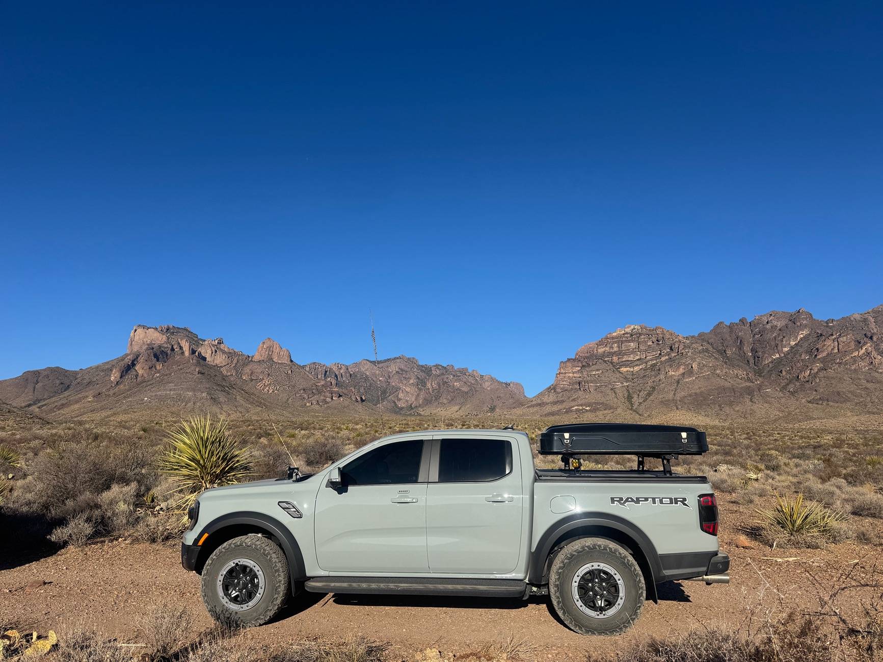

Has anyone installed Dobinson rear spring on their Ranger Raptor?? Im wondering how much lift it will give to my saggy Raptor. I have Retractable cover + RTT which are about 270lb combined with cross bars. Then there will be another 300-400lb of camping gears that i need to carry for overlanding trip.
I think this will be my perfect set up with 2” strut spacer lift from GOAT Offroad:
https://dobinsons.com/ford/ford-86/ford-86_rear/ford-86_rear_coil-spring/ford-86_rear_coil-spring_c19-523-detail
Btw, attached pic is an example of fully loaded set up (approx 500-600lb total payload)

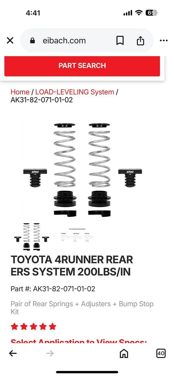

It would be nice if Eibach made these for raptor.
I ran these rear adjustable on my 4Runner and were great for adjusting when needed
