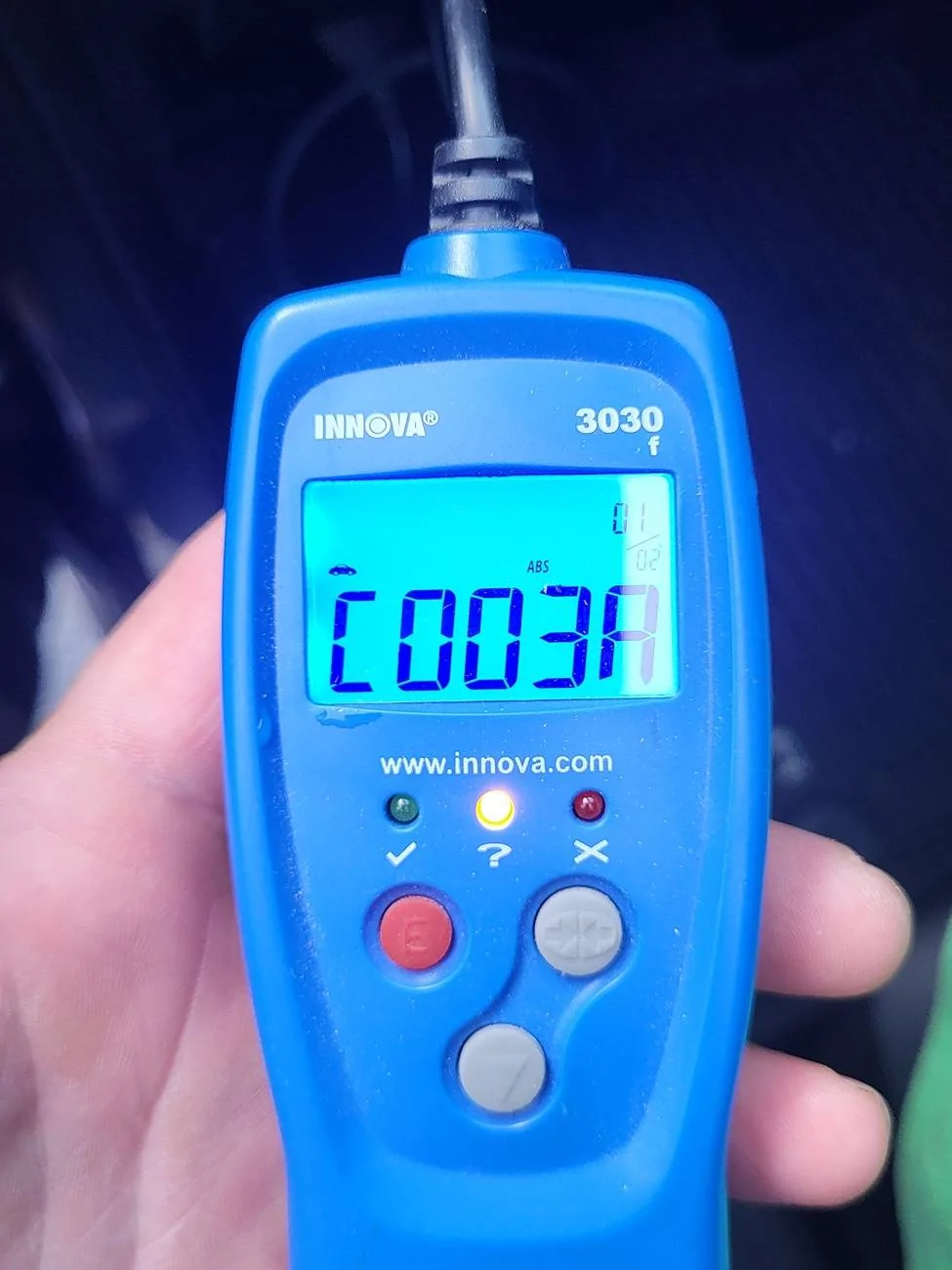

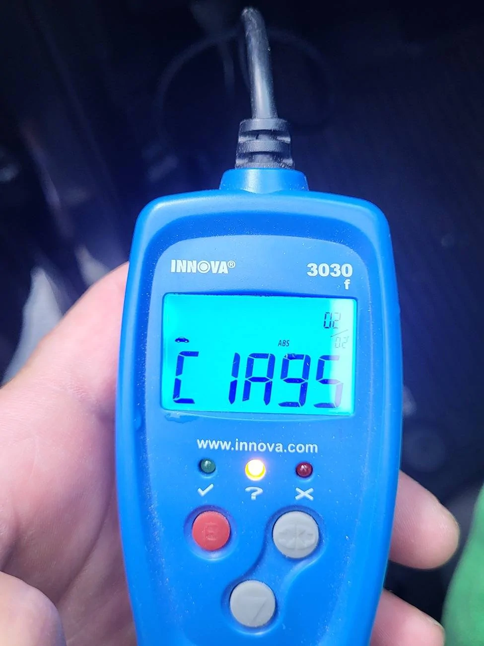

Depotgeorge
George
Jun 13, 2024
Nj
24 ranger
Rear wheel sending unit is bad failed under 500 miles back in august . Dealer pulled a few codes and now have to wait for parts to be made unknown time for repair.
Ford Ranger "Check Brake System" warning 20240630_181231
Ford Ranger "Check Brake System" warning 20240630_181227
