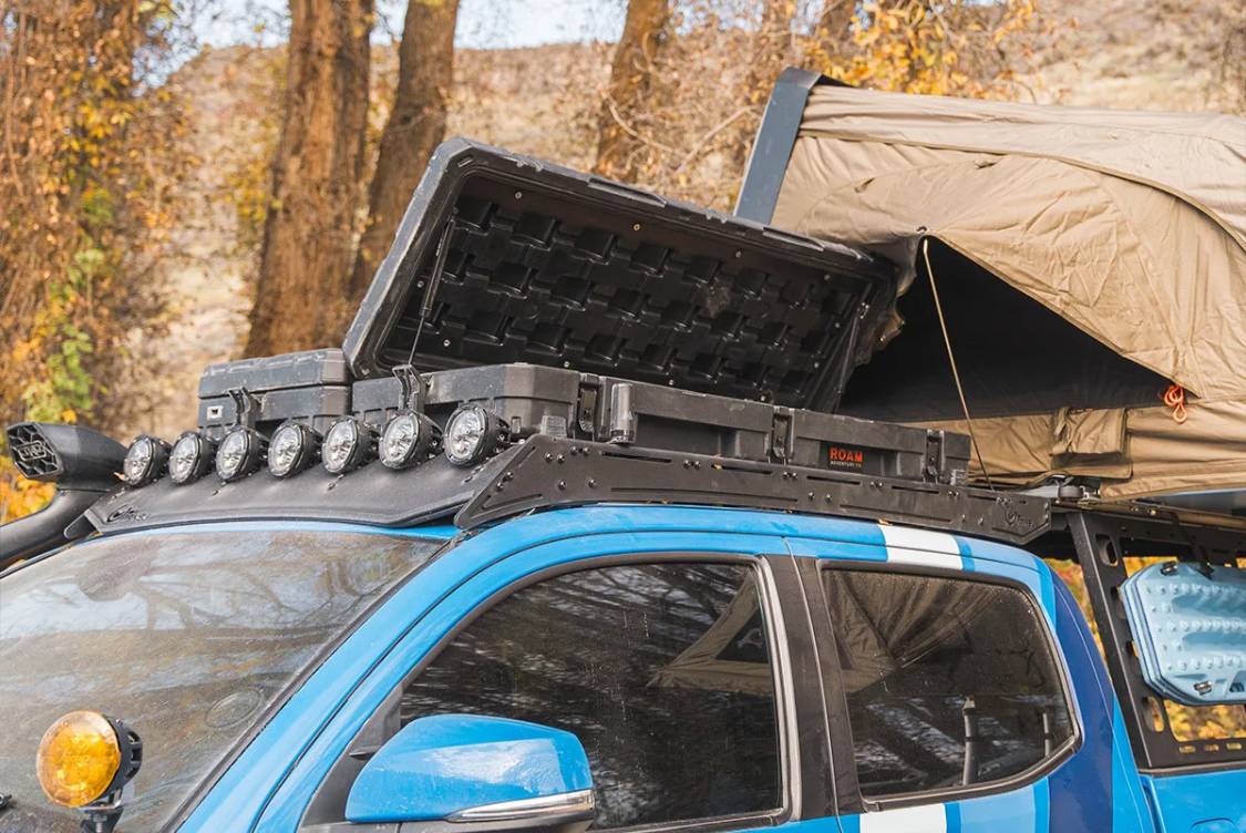

Any idea how many support bolts per side, and what the actual dynamic load rating would be? Prinsu says 300 pounds but that figure has not been tested ;( Their show truck in your image would be pure nasty offroad without a doubt - including the bed rack and tent, it probably has 400 pounds of parts and gear up there. Expedition racks are trendy and cool, but you have to use common sense about how much heavy junk you put up there (no jerry cans and jack!)… if you need to carry that much stuff a trailer is way better.

FYI, I have one of those Roam boxes and it's a 83L case. Not as tall as a 95L one. I bought a used one for $200 and like it a lot. I have it mounted on the top of my bed rack and use it to hold all of my recovery gear.
