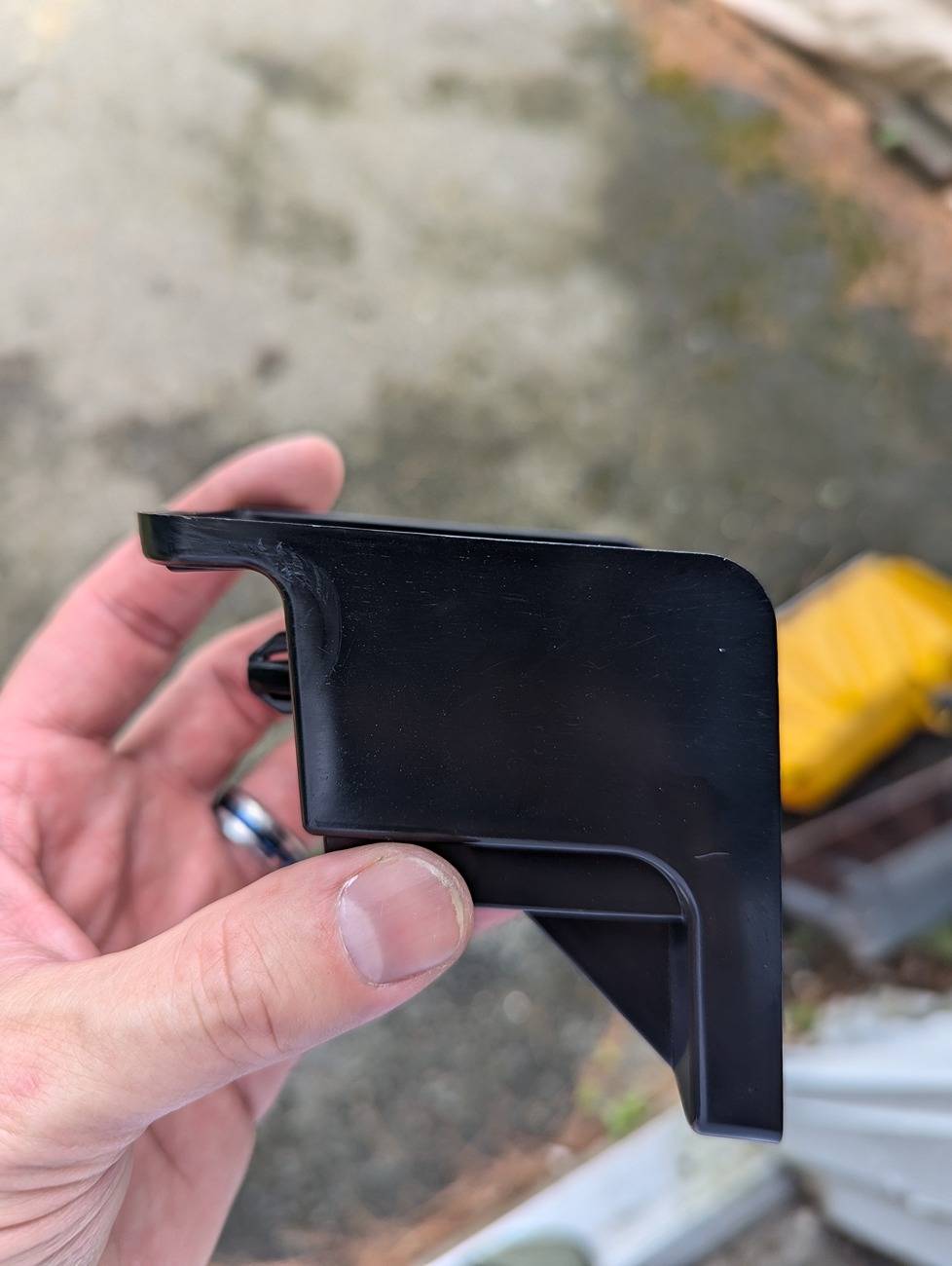

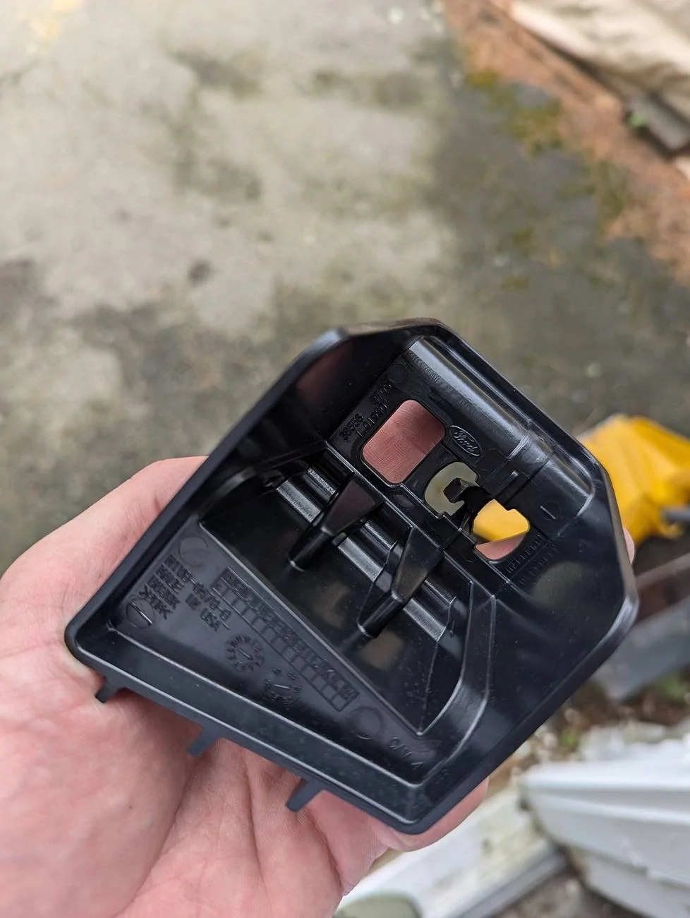

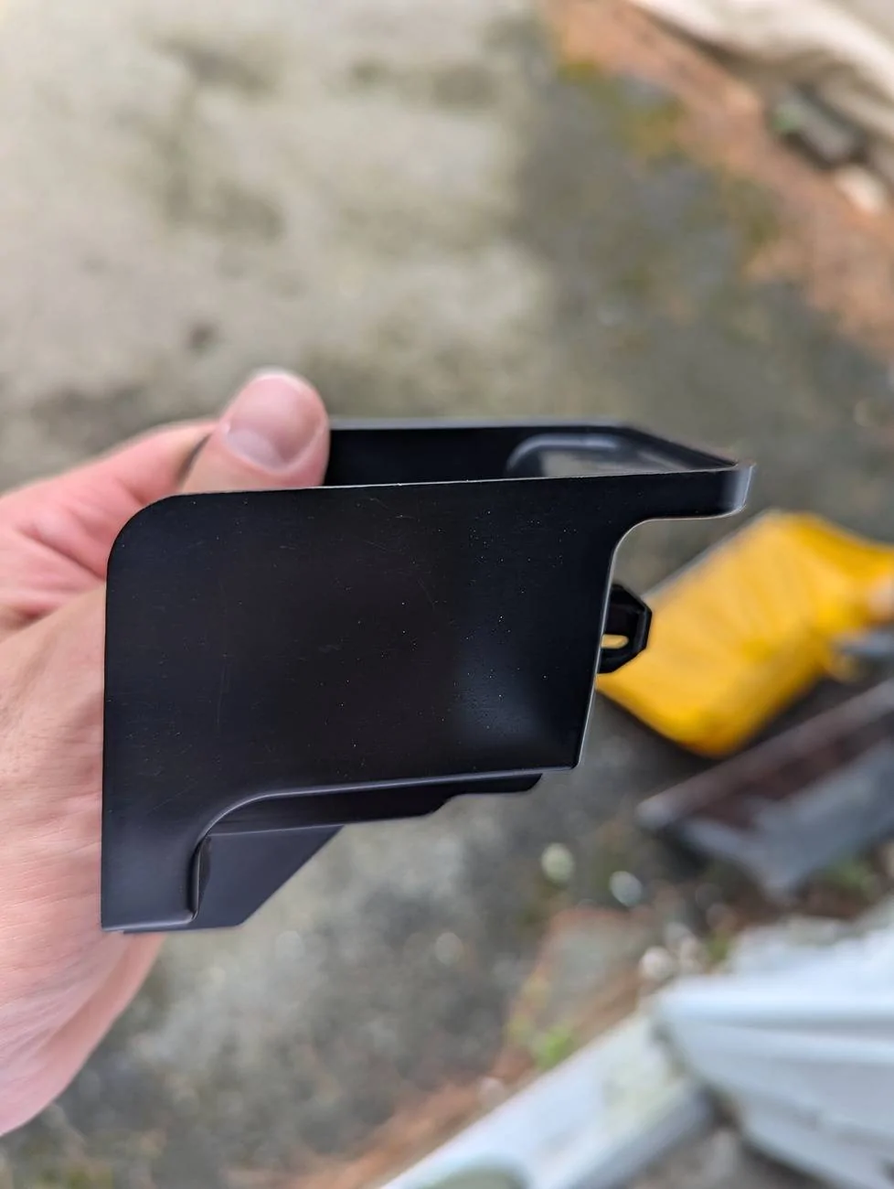

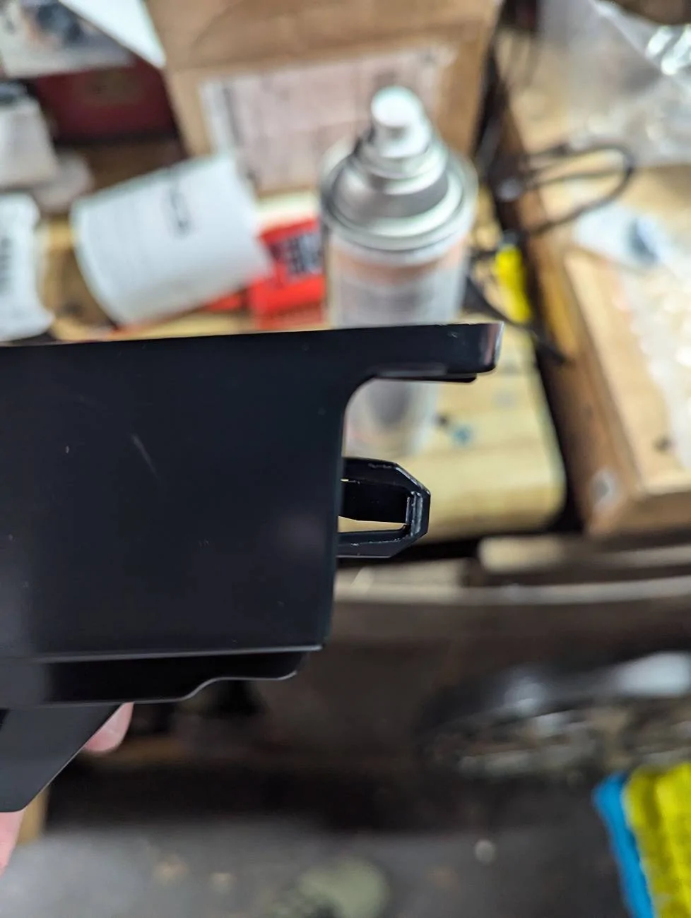

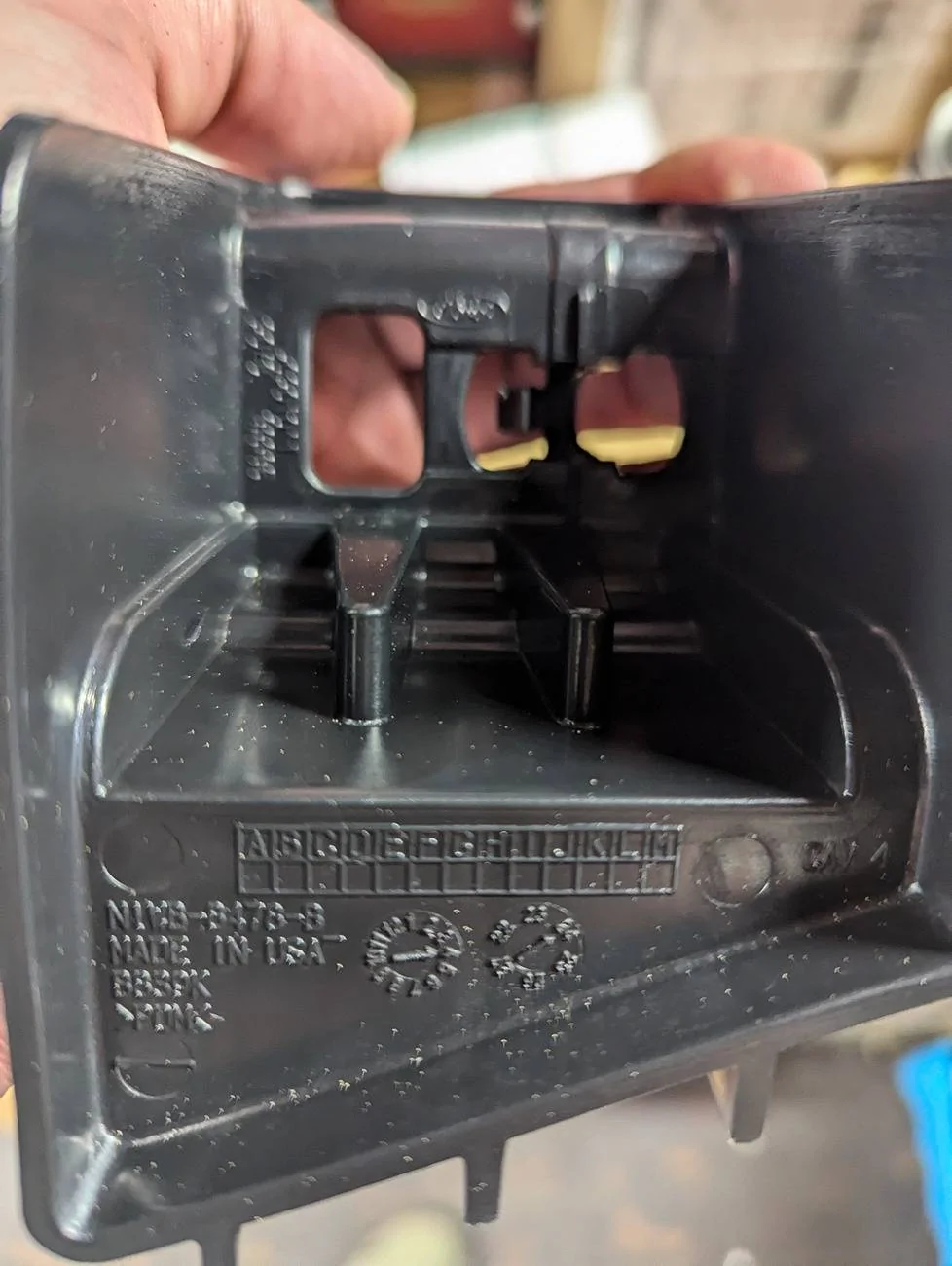

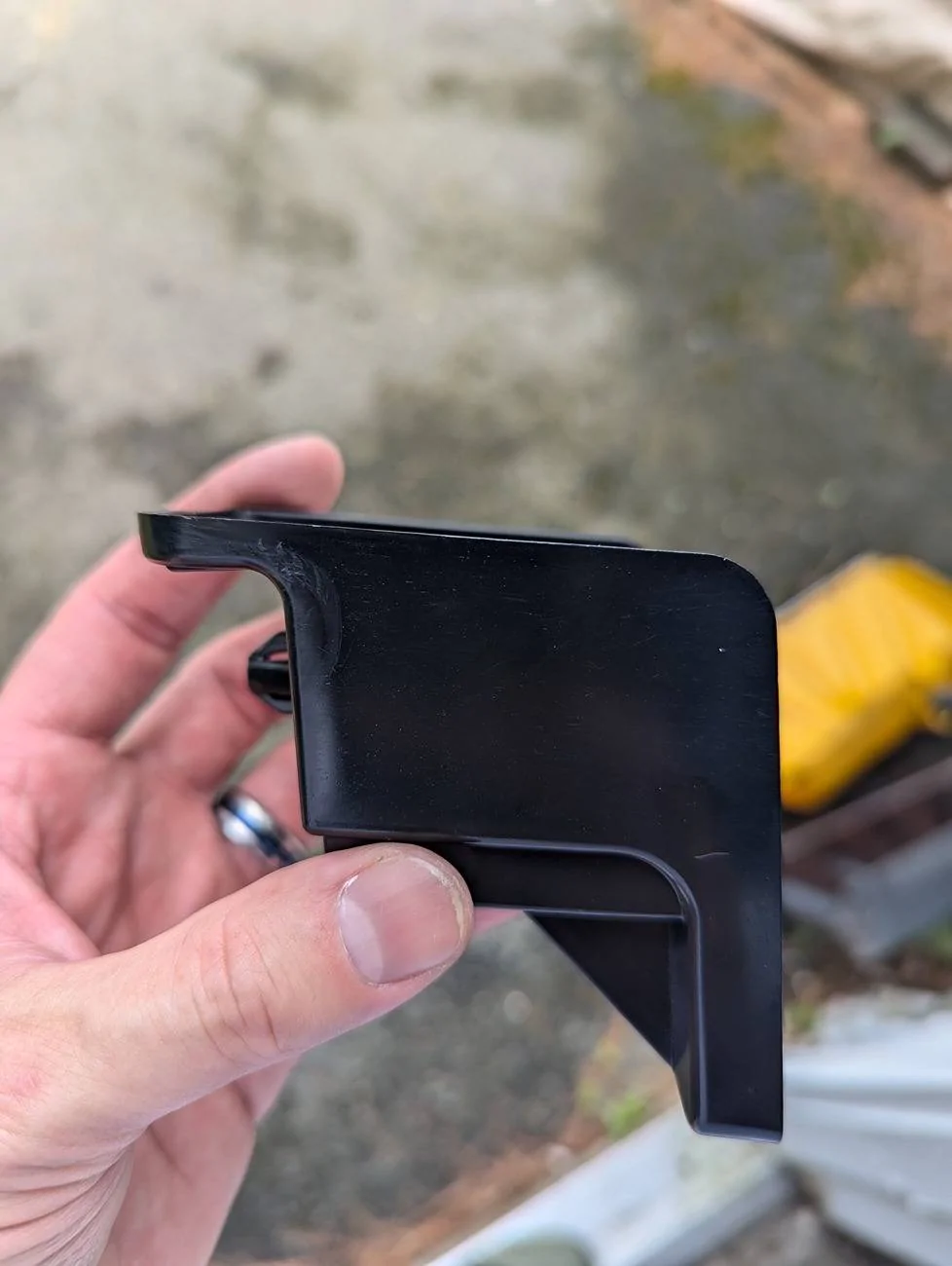

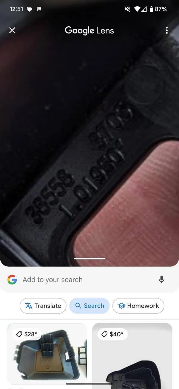

While adjusting the hood latch this morning due to having to slam the heck out of the hood to latch since delivery, when I pulled up on the 3 piece radiator cover, a piece of plastic fell into the engine bay. Has a number: n1wb-8478-b I wasn't paying attention to where it fell from. The push retainer is also broken on one side. (2024 Ranger Raptor). Hood closes perfect now with the hood deflector. Lol
Sorry to hear it broke. Maybe the dealer will replace it.

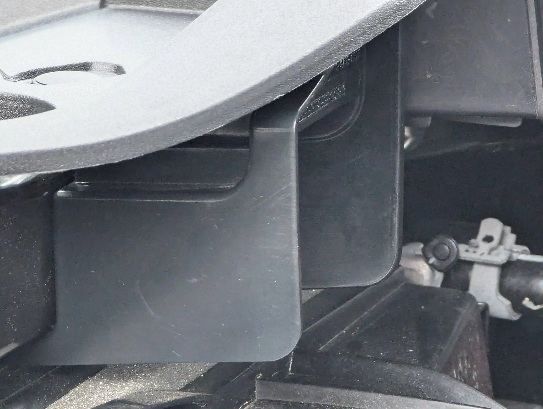

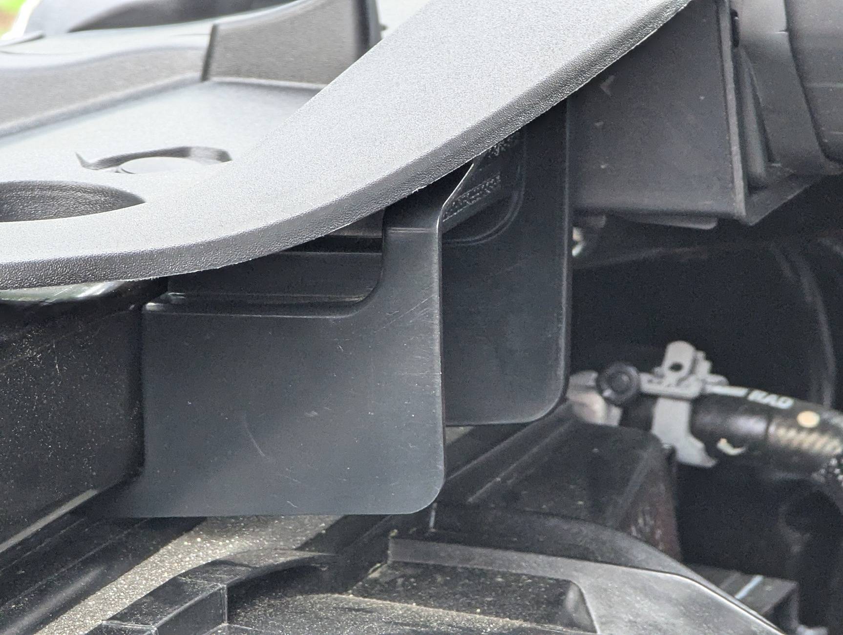

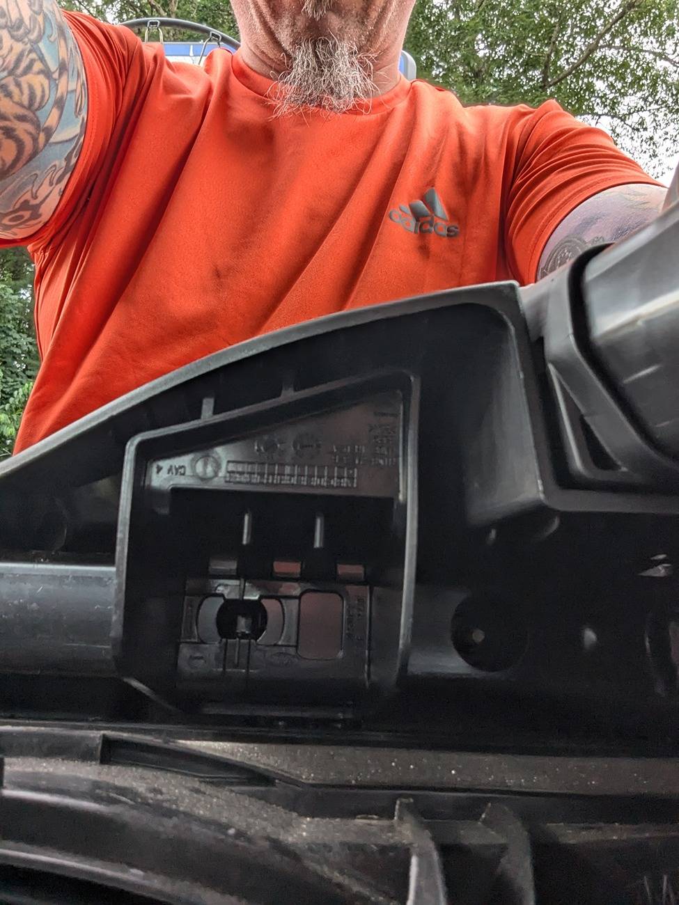

I think I figured out where it goes. Now I just need a replacement.

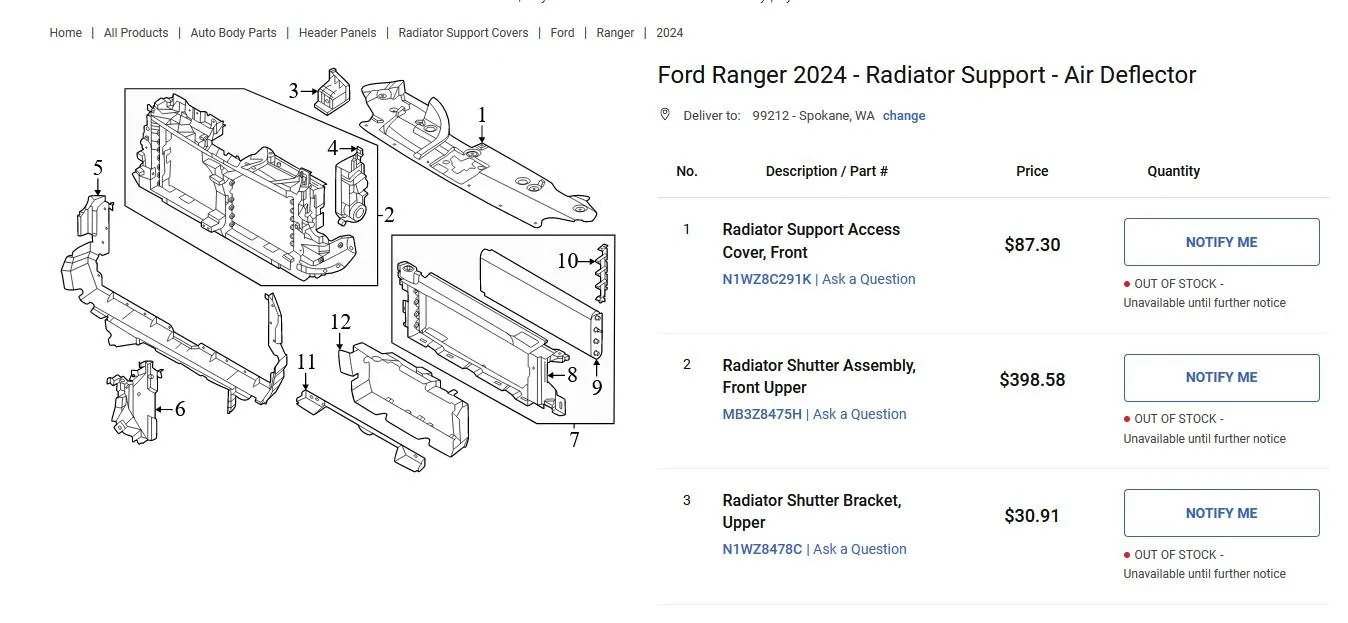

@ADDGAMER is your "think I know were it goes" on the left side of the open engine bay?
Other web-forums note the most important section of the Part Number are the 4-digits between the two letter/digit sections. N1WB-8478-B
With the 8000-8499 sereis being 'Radiator-Grille' parts
So your part could be / is(?) Item # 3 in this diagram {{n1wz8478c}}

Awesome, Thank you!!
