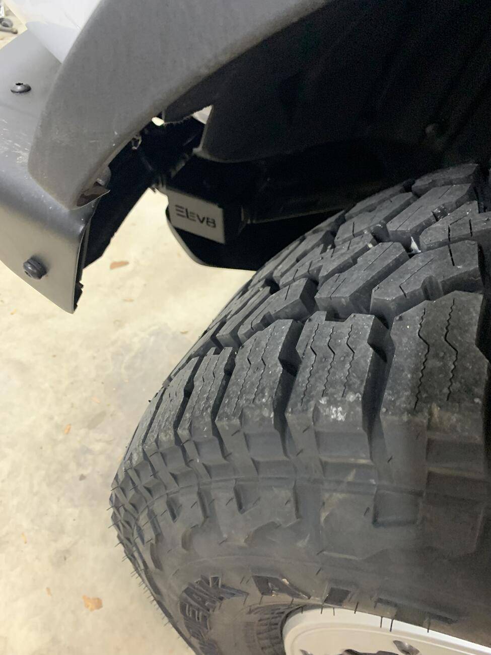

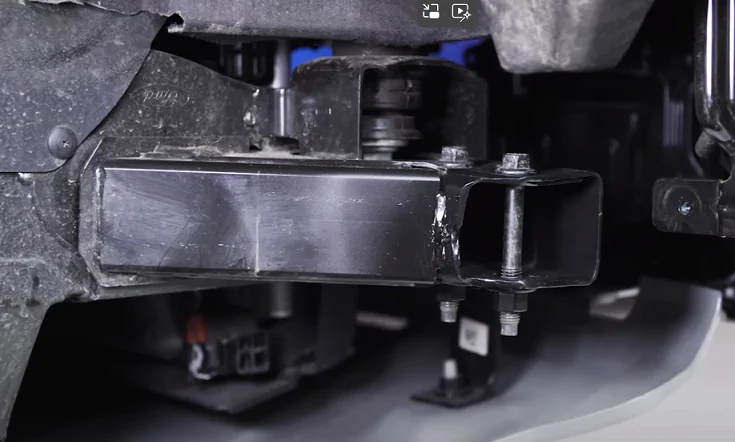

The crash bars look about the same as the process for the Bronco's
This guy is going to a lot of effort to keep them but they seem to be no big deal on the Bronco.

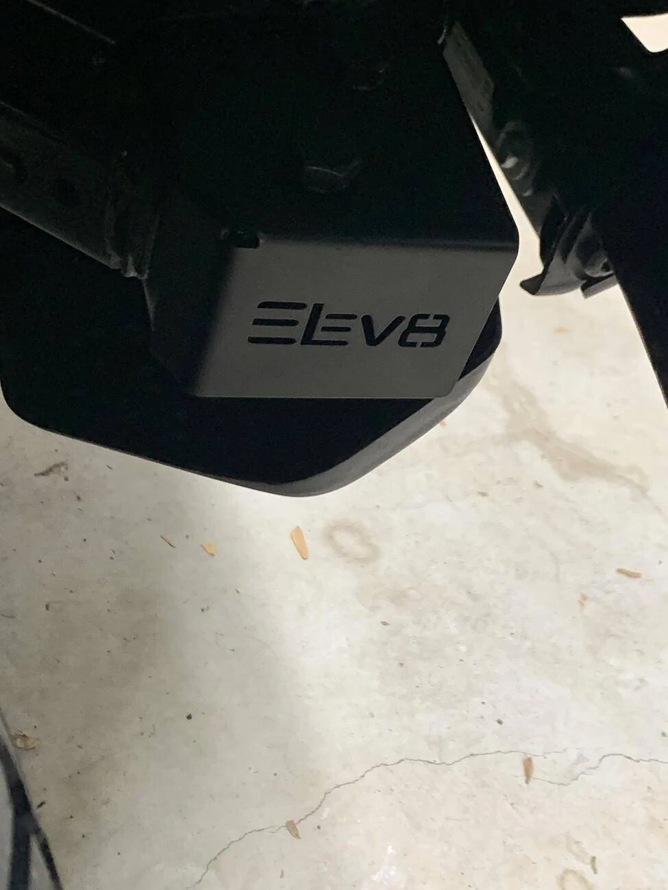

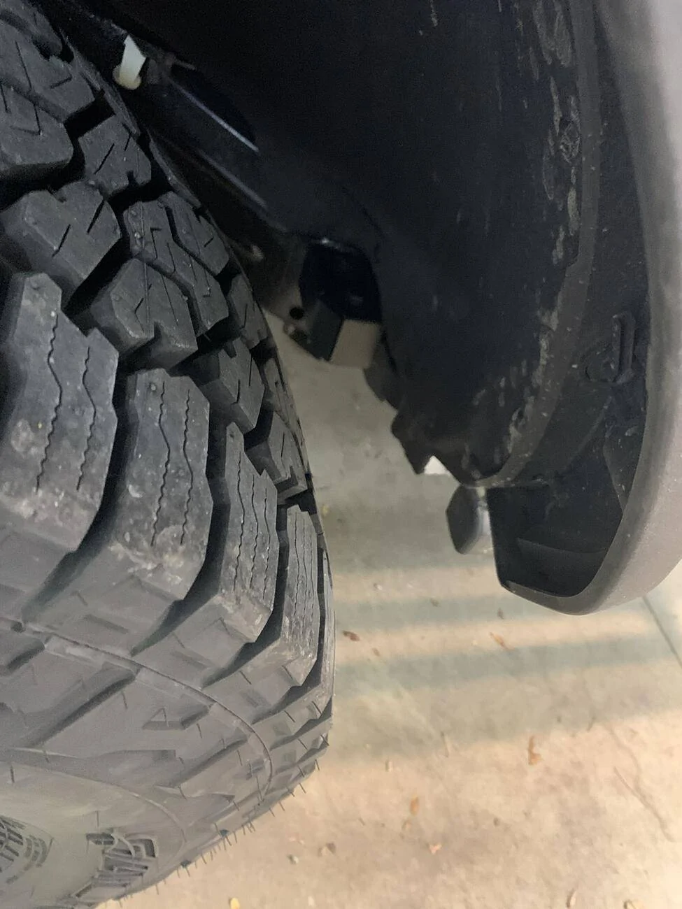

Ford removes them for the 35" tire factory optioned Broncos. Mine never installed or removed by Ford since my Bronco came with the SAS pkg. I bought these aftermarket covers to clean up my fender wells on the Bronco.
Bronco Crash Bar END Caps – ELev8 Off Road

2019-2023 Ford Ranger Wheel Spacers & Cutting Crash Bar Vlog (youtube.com)
