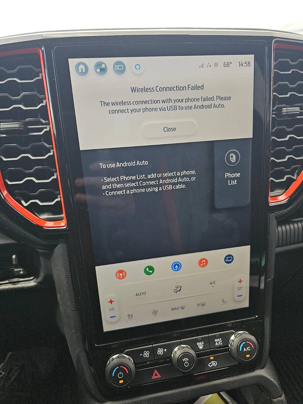

After seeing the post about Apple Carplay and all of its disasters. I decided to make a post about my issues with Android Auto. Is anyone's wireless Android Auto randomly cutting out? I can connect the USB and have no issues, but on wireless AA sometimes it doesn't happen at all, and other times it will happen back to back or a few times whenever I am driving. I have another vehicle that is a Toyota where this does not happen at all. I told my dealership about the issues but they did not do anything about it. So now I am going to have to press more into it since it is happening frequently and only with my Ranger Raptor, but mostly wanted to see if the consensus is having the same problems as myself.

What phone do you have? I have a Galaxy S24 and have not had any issues with AA disconnecting. My only issue is sometimes texting notifications can be almost a minute delayed.

My RR is at the dealer for warranty work. The rental I was given is a 24 Edge. Received the same wireless connection error. Phone wouldn't reconnect. Put vehicle in neutral, held start button to power cycle vehicle, and phone reconnected immediately.
