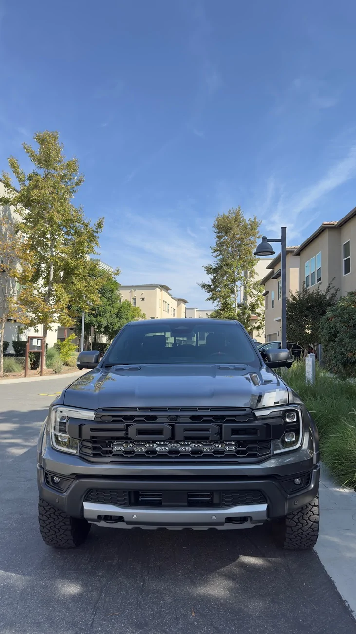

anyone installed the 28" on non-raptor models?

I have the double stack light bar, it's awesome. Looks great

I ordered this morning :) how did you wire it?AUX direct?

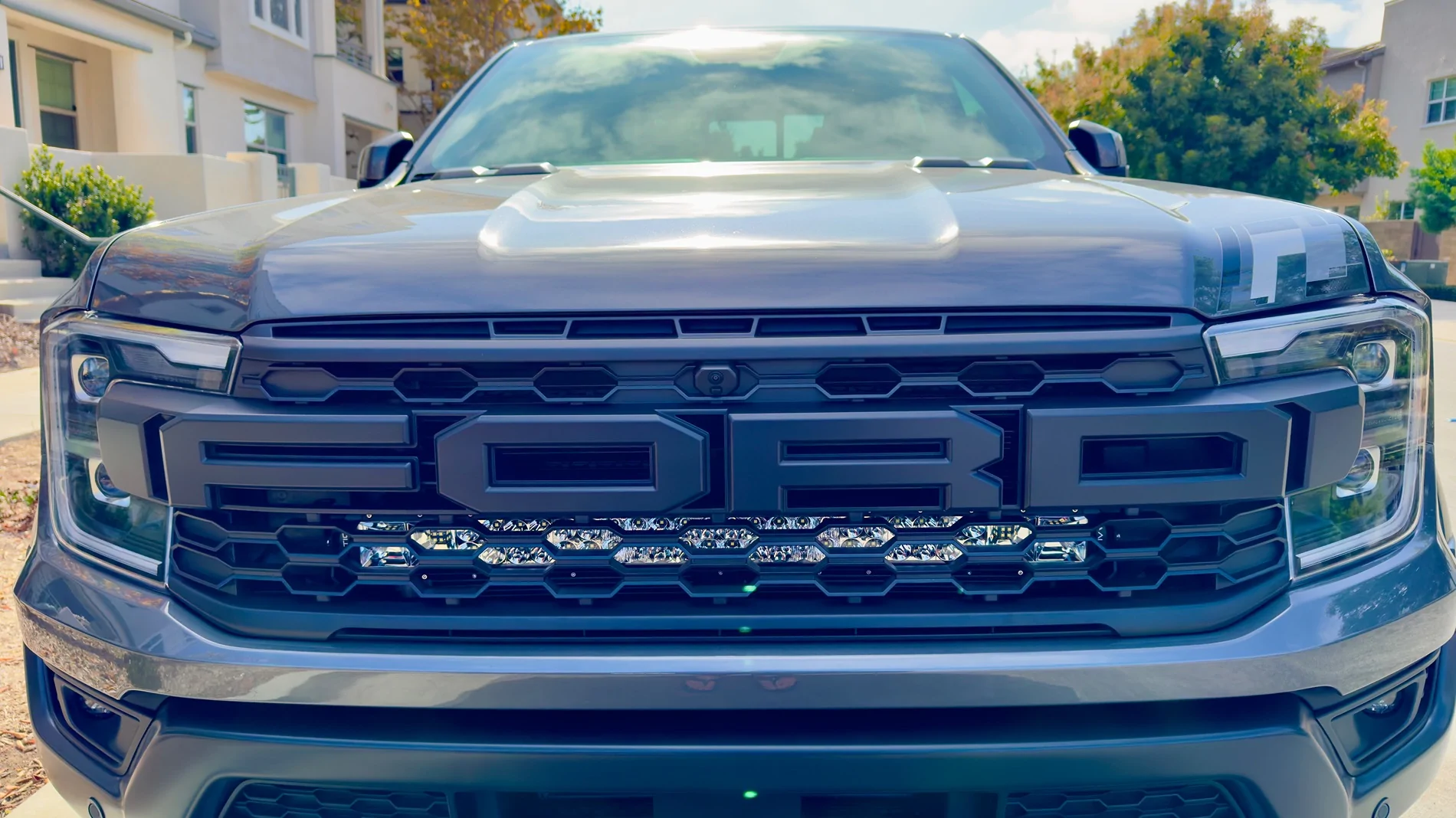

Super good quality. For mine I did AUX6 (us model) the wiring for it drops right behind the front grille.
I will use aux5 as 6 is used by compressor. Did you ground to frame or used the aux ground wire?

installed the bar, pretty awesome and now I can pop AUX5 too

I too installed one. Easy to install and great value. Would’ve taken about 20 minutes to install if I hadn’t left a socket under the radiator cover. 😡

had to trim a couple of mm of the inner side of the grill, but beside that, it was a breeze. actually the worst part was finding a good routing for the cable...the way ALTIQ does is really bad, with wire hanging in front of the radiator...I did fin a good routing next to the headlamp and through the frame to get to AUX wire. plug covered under the plastic cover on top of the grill.
out of curiosity,...how did you position the light bar beam?just above the highbeam or through it?

Through it. I have only used it against the garage door thus far so I’m not sure if it’s where it needs to be just yet.
i was so impressed with their light bar I ordered a couple of their work lights for the back of the truck.

yeah the bar is awesome and I used it in the bushes...beside the spot which is nice but really works only in the desert, it's all the other lights that make the difference creating a daylight surrounding the front of the car view
