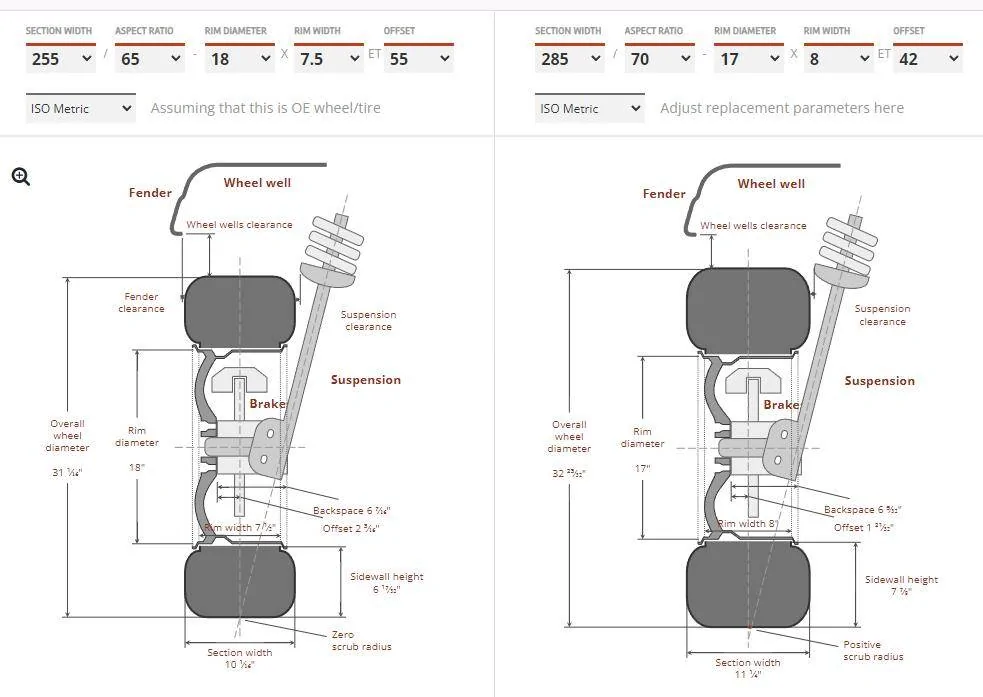

Anyone try something like a 285/70-17x8 E42 on a stock FX4 suspension?
Ford Ranger 255/65-18x7.5 E55 (OEM) vs 285/70-17x8 E42 1730329989993-ik

I think its too close but don't know. That tires size the only offset we know that works is +35.

Who has the +35 setup? Can you share specifics, pics? TIA!
