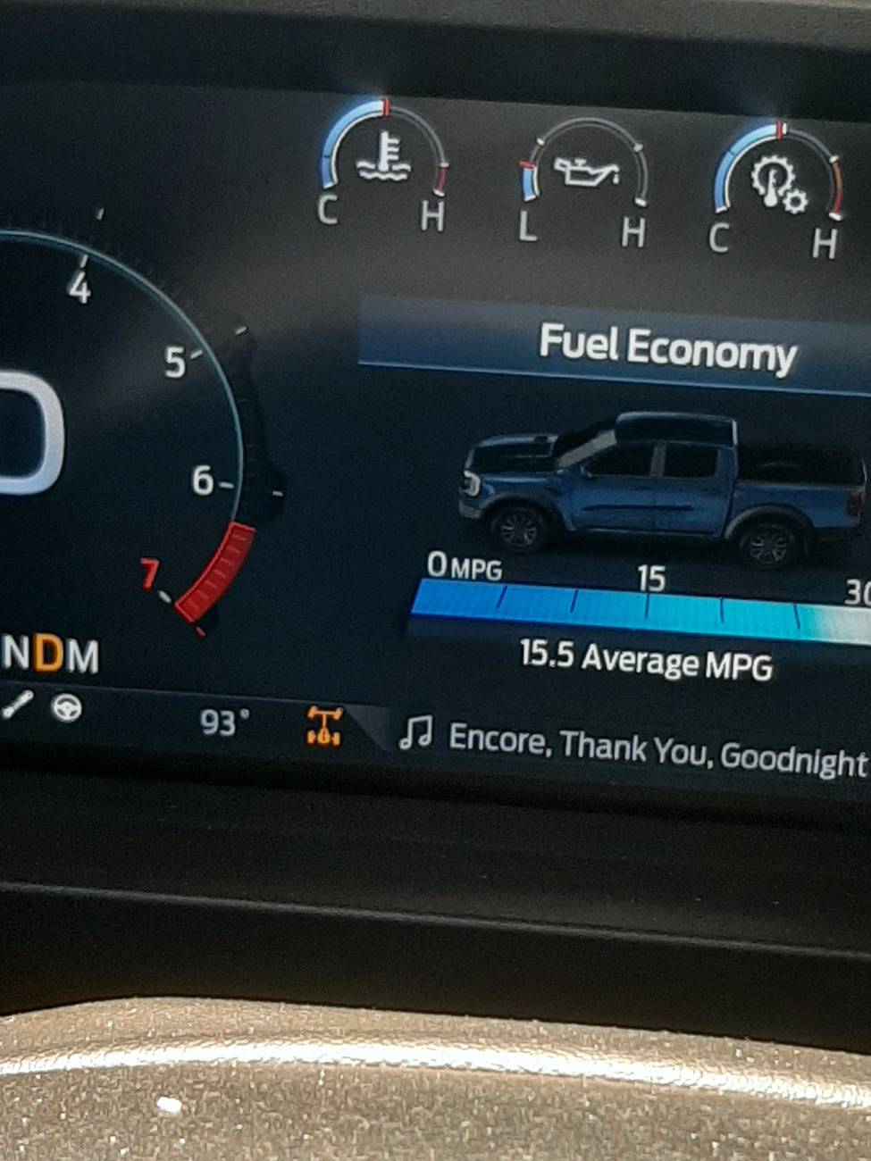

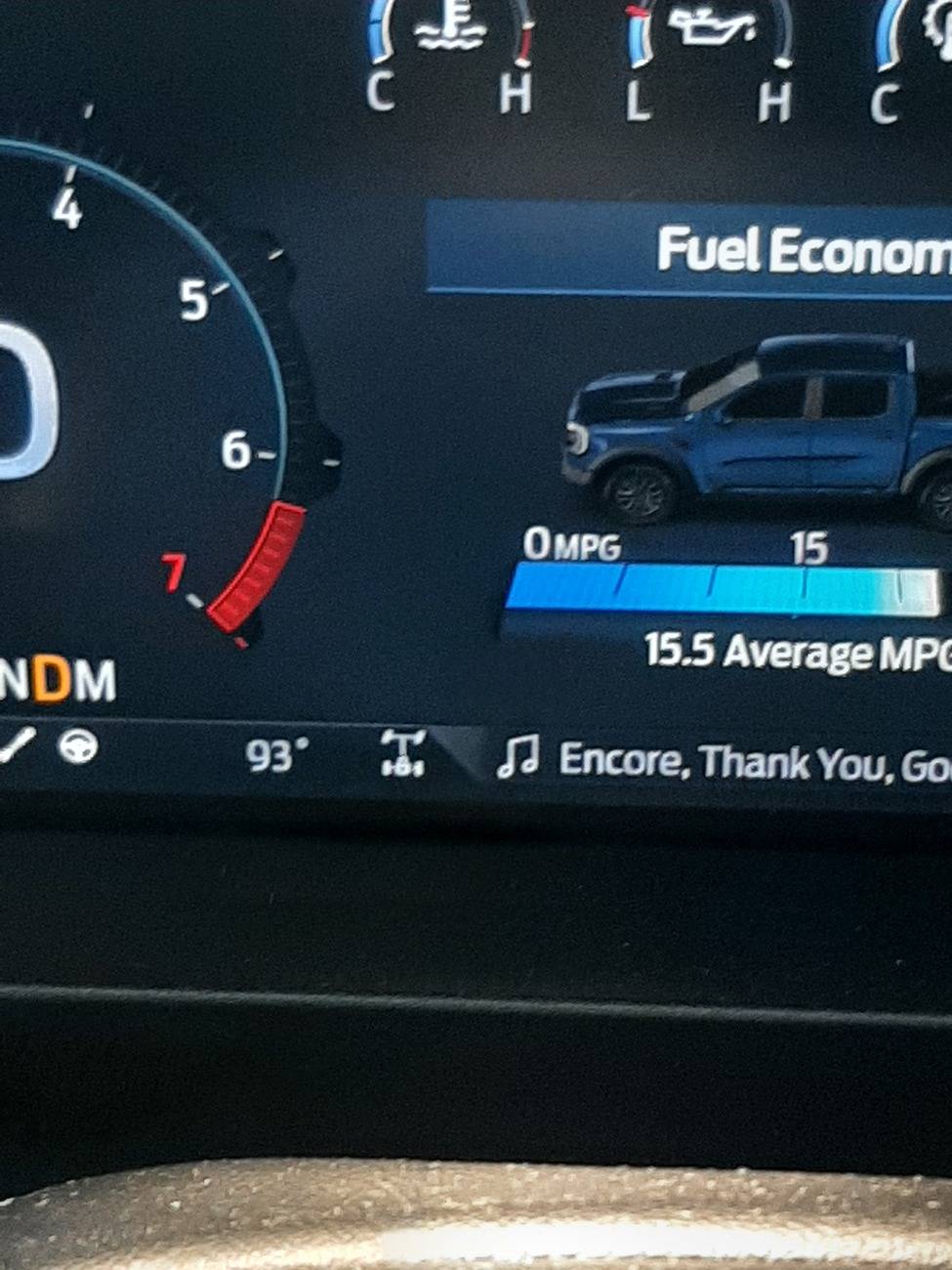

Shifted my 2024 ranger raptor into 4L to pull a log... Truck worked great, now I can't get the truck out of 4 x 4. Pictures attached show what the gauges are saying while drive setting is 2H. symbol goes orange once I get below 25 miles an hour any help would be greatly appreciated.

I'd try shifting into neutral at a dead stop, turning the locker off from the offroad screen, shifting into 2H (or trying to), and then into reverse and back up for about 5-10 feet. I had a Tacoma that would get stuck in 4L and backing up always did the trick to get the t-case to act right.

Thanks for the tip! Never have been on the off-road screen. Once I turn the locker off everything seemed to be back to normal.
