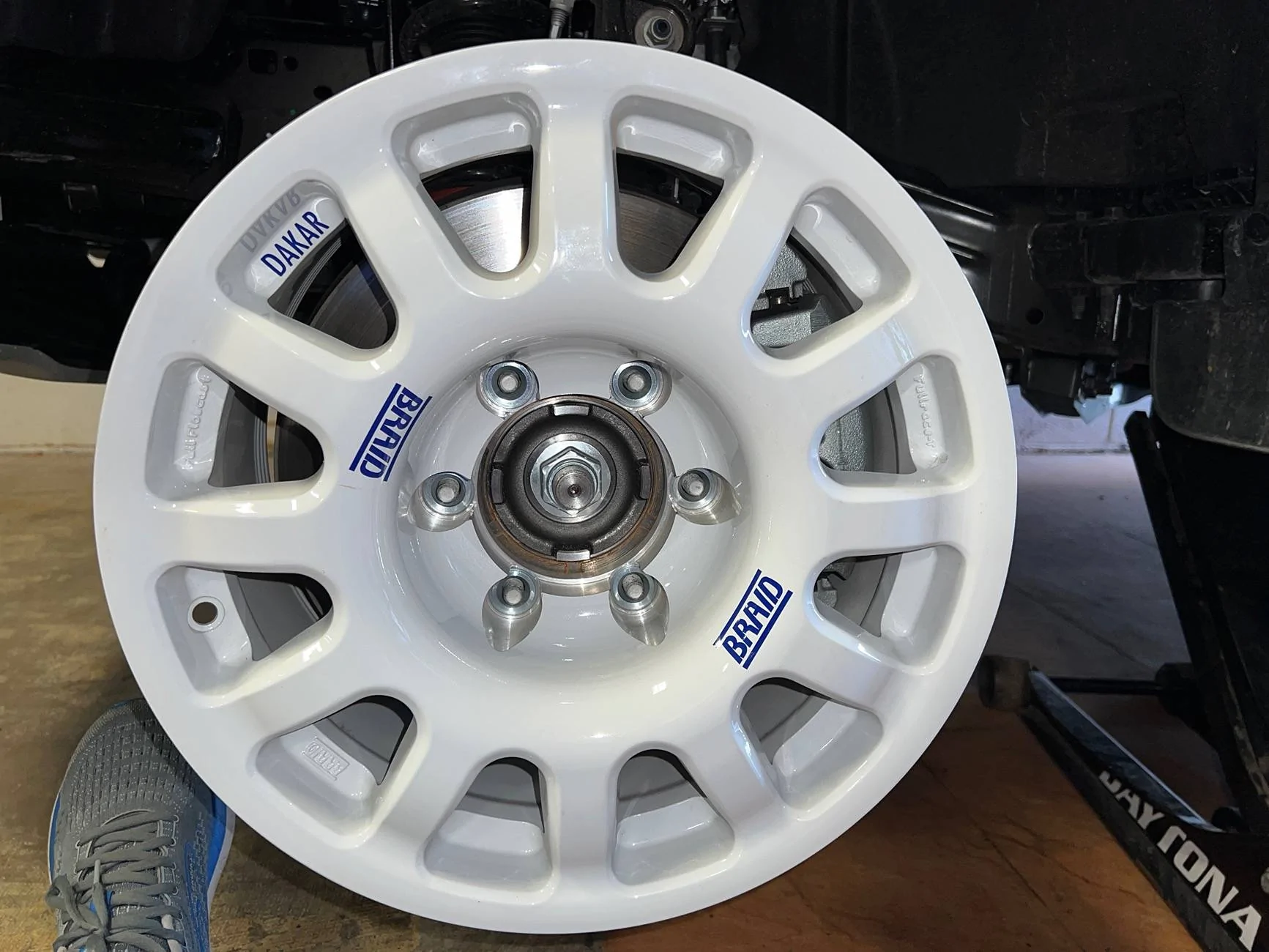

I was at Braid USA the other day to test fit a few wheels and we tried a 16” Fullrace Dakar just for the heck of it. I’ve heard that the Ranger Raptor calipers are beefier than the standard Bronco hardware and this confirms it - the caliper was contacting the wheel at multiple points. It’s close, but ultimately 16s won’t fit on the RR.
Ford Ranger 16” wheels do not fit RR IMG_0261
We ended up putting an order in for a set of Braid Fullrace T Dakar 17x8 wheels
40mm offset 93.1mm hub. 6x139.7 in Anthracite with the Beadlock B System and a Knurled bead seat.
Will report back when they arrive in a few weeks!

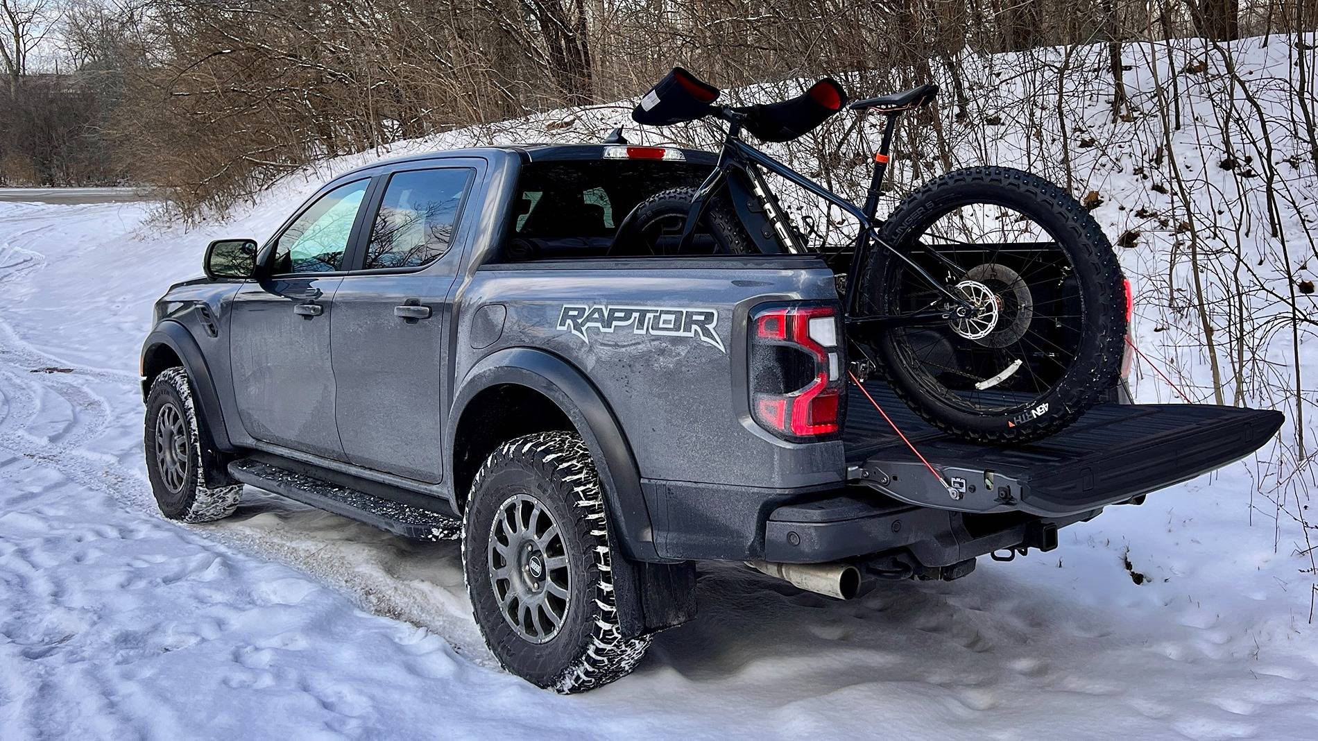

Been happy with them so far! Braid usually keeps their wheels in production for a long time, and if you need a custom replacement it only takes a few weeks. They are definitely a premium wheel. Will have to properly put them to the test at the dunes in the spring.
